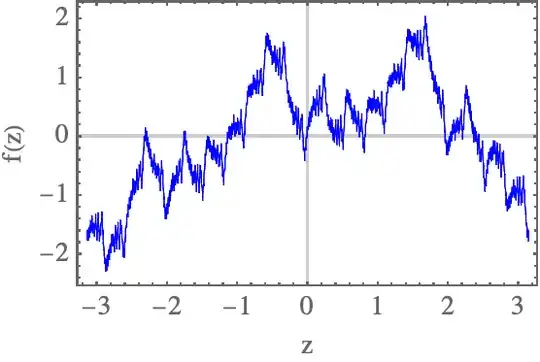

Instead of proving convergence, I'll try calculating the limit.
For some large positive integer $n$ we have $$ s_1 = \sum_{k=1}^{\infty} \frac{\sin(k(k-1))}{k} = \sum_{k=1}^n \frac{\sin(k(k-1))}{k} + \sum_{k=n+1}^{\infty} \frac{\sin(k(k-1))}{k} $$ The first term we can calculate exactly. For the second term we assume that $k(k-1)\mod2\pi$ is distributed uniformly in the interval $[0,2\pi)$ and so the sine functions can be replaced by independent random variables with zero mean and a variance of $\frac12$. We find the mean value $$ \langle s_1\rangle = \sum_{k=1}^n \frac{\sin(k(k-1))}{k} + \sum_{k=n+1}^{\infty} \frac{\langle\sin(k(k-1))\rangle}{k}= \sum_{k=1}^n \frac{\sin(k(k-1))}{k} $$ and the total variance $$ \text{Var}(s_1) = \sum_{k=n+1}^{\infty} \frac{\frac12}{k^2} = \frac12\psi'(n+1)=\frac{1}{2n}+O(n^{-2}). $$ We thus find the physics-style estimate $$ s_1 = \left[\sum_{k=1}^n \frac{\sin(k(k-1))}{k}\right] \pm \frac{1}{\sqrt{2n}} $$ for $n\to\infty$.
Using $n=5\times10^7$ terms in the first sum, I find $s_1=0.3128±0.0001$.
In the same way, $s_2=0.1667±0.0001$.
More generally, we can try to plot the function $$ f(z) = \sum_{k=1}^{\infty} \frac{\sin(k(k+z))}{k} $$ where $s_1=f(-1)$ and $s_2=f(0)$: this function seems to have a lot of structure,

    @ Roman +1 That's really elegant. In my comment using the random procedure I missed your splitting of of the sum into low and high end. The physics-style argument is convincing for me (as a physicist) although strictly speaking Weyl does not guarantee randomness for integer coefficients of the polynom P(n) (see my comment to Greg Martin). – Dr. Wolfgang Hintze Dec 08 '19 at 08:44
  • @Dr.WolfgangHintze yes, strictly speaking the assumption of randomness is just an assumption, and my results may be quite wrong. I suspect they are alright though, and would be interested in seeing an example of a deviation. I'm a physicist too, and think of irrational numbers in the way used here, for practical purposes. – Roman Dec 14 '19 at 19:49
  • @ Roman The more I think about your approach the more I like it. You might perhaps also be interested in my attempt to attack the sum analytically https://math.stackexchange.com/a/3466679/198592 – Dr. Wolfgang Hintze Dec 16 '19 at 08:22
  • @Dr.WolfgangHintze your Fourier formula looks interesting but I haven't been able to evaluate it into a simple result. Maybe it just transfers the difficulty to a different spot: integrating this formula over intervals of length 2pi and then summing these results (to infinity). But a good idea for sure. – Roman Dec 17 '19 at 19:48
