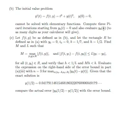

Please note I have solved parts a and b, I have also calculated the value of $L$ using the formula given, however I don't know how to calculate for $M$. It says $\max|f(t,y)|$ so am I supposed to use $y(t)=y_o+f(t_o,y_o)\,(t-t_o)$? I used that but then $y(t)$ will be $0$ and therefore $\max|f(t,y)|$ will become only $t^2$. The value of $t$ which I got while calculating $L$ is $1.03393$ and using that $h<1/L$ condition is satisfied, however $Mh<b$ condition is not being satisfied.
Can someone help me on this? Any help will be greatly appreciated.

The formulation of part b) is somewhat ambiguous. What is meant is that the function $f$ is defined as $f(t,y)=t^2+y^2$, and then the differential equation, the classical quadratic Riccati equation, is $y'(t)=f(t,y(t))=t^2+y(t)^2$. The first is an ordinary function definition, the second a functional equation for $y(t)$.
Thus the easiest part is to determine the bounds, $$ M=\max_{|t|\le h,\,|y|\le b} |f(t,y)|=h^2+b^2, $$ and the Lipschitz constant is determined from $$ |f(t,y_1)-f(t,y_2)|\le 2b|y_1-y_2| $$ as $L=2b$.
Now you have to balance the equations $$ q=Lh=2bh<1~\text{ and }~ Mh=(b^2+h^2)h\le b. $$ (Or use strict inequalities everywhere). Or rather confirm that indeed with $h=\frac12$ you get $q=b=\frac17<1$ and $Mh=\frac1{98}+\frac18<\frac17\iff 98>56$.
