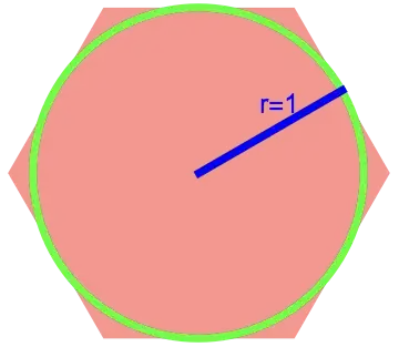

(Credit to David G. Stork for the image).
I am showing the area-based argument explicitly because it seems that the other answers rely on a perimeter-based argument (which I find unconvincing without a rigorous proof). In contrast, it is quite easy to conclude by simple inspection that the circumscribed hexagon has a larger area than the inscribed circle.
The area of the circle is clearly simply $\pi$.
The hexagon can be decomposed into six congruent equilateral triangles. The height of each is $1$. The base can be computed with trigonometry as $(2)\tan\frac{\pi}{6} = \frac 2{\sqrt 3}$. Hence the area of a single triangle is $\frac 12 (1)(\frac 2{\sqrt 3})= \frac 1{\sqrt 3}$. The area of the hexagon is therefore $\frac 6{\sqrt 3} = 2\sqrt 3$.
This allows us to immediately conclude $2\sqrt 3> \pi$ as required.

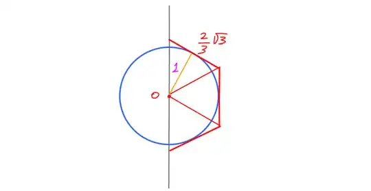

By a geometric argument just consider a circle inscribed in an hexagon and compare the two perimeters to obtain
$$3 \cdot \frac23 \sqrt 3 > \pi \cdot 1 \iff 2\sqrt 3>\pi$$
