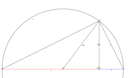

For the sake of completeness I am adding a well known geometric proof of this inequality:
enter image description here Combining the cathetus theorem ($s^2=b(a+b)$) and Pythagoras' theorem we get: $GM=\sqrt{b(a+b)-b^2}=\sqrt{ab}$.
And since the diameter $a+b$ of the circle c is twice the radius, we get: $AM=radius=\frac{a+b}{2}$
