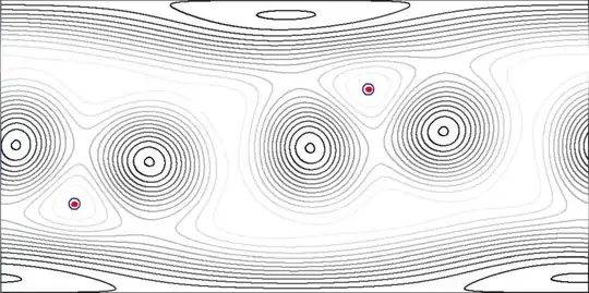

Update in response to the comment by David Speyer.
Due to the constraint $x^2+y^2+z^2=1$ the whole problem can be re-formulated in spherical coordinates: $(x,y,z)=(\cos(\theta)\cos(\phi),\cos(\theta)\sin(\phi),\sin(\theta))$ with $-\pi/2<\theta<+\pi/2$ and $-\pi<\phi<+\pi$ . Substitute these into $f(x,y,z)$ and make a contour plot $(\phi,\theta)$ . We have done this for $f(x,y,z) = k/3 \; , \; k = 1,\cdots\,15$ . Darker lines correspond with larger values of $f$ . Places where $f(x,y,z) < 0.01$ are colored $\color{red}{red}$ and the places of the minima $\;\pm 1/\sqrt{3}(1,1,1)\;$ in spherical coordinates are indicated with a $\color{blue}{blue}$ circle. We see that the circles and the red spots coincide and that the function values are uniformly decreasing in the neighborhood of these.

    That verifies that $f$ has a local minimum at $(r,r,r)$, subject to the constraint. But it doesn't show that it is a global minimum. – David E Speyer Jan 14 '14 at 11:44
  • @DavidSpeyer: Thanks; see my update. – Han de Bruijn Jan 14 '14 at 19:43
  • Nice image! It looks like there are $6$ other local minima ($3$ modulo the antipodal map), sitting at the bulges of the roughly equatorial band in light gray. Is that right? Many local minima are often an obstacle to easy proofs of inequalities. – David E Speyer Jan 15 '14 at 19:26
  • @DavidSpeyer: You're quite right. There are many other local minima, but none of them as deep as the two indicated (i.e. the two that we know about). In retrospect, half of the picture i.e $0 \le \phi \le \pi$ would have been sufficient as well. – Han de Bruijn Jan 15 '14 at 19:59
  • Then $f(x,y,z)=0;$ corresponds with $(\theta,\phi)=\arcsin(1/\sqrt{3},1/\sqrt{2})$ . – Han de Bruijn Jan 15 '14 at 20:35
