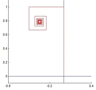

Take a look at this graphical representation of your series :
which enters into the (disputed!) category of "graphical proofs". (Therefore, I do not pretend that it is a full fledge proof !)
This inward spiraling is a testimony of the convergence of the series.
But to which complex number ? To
$$-\frac12 \log(2)+i \frac{\pi}{4} \approx -0.3466+0.7854 i \tag{1}$$
(check it on the figure !). Why that ? Because your expression, now that we are confident that it is a convergent sequence, is the value in $x=i$ of the classical series :
$$\frac{x}{1}+\frac{x^2}{2}+\frac{x^3}{3}+...=-\ln(1-x)\tag{2}$$
Converting $1-i$ into its equivalent trigonometric form $\sqrt{2}e^{-i \tfrac{\pi}{4}}$, (2) is transformed into
$$-\ln(1-i)=-\log(\sqrt{2}e^{-i \tfrac{\pi}{4}})\tag{3}$$
finally giving expression (1)
Important remark : in fact, in (3), we have manipulated the complex logarithm function as the familiar real logarithm function. We are fortunate that we are in a case where it is harmless. But if one day you have lectures on complex function theory, you will be introduced to all subtleties of $\log:\mathbb{C}\to \mathbb{C} $ and its "branches" (we have been using the "principal branch" here)...
Jean Marie
  • 88,997
