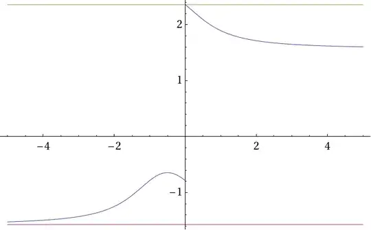

Note that $\cot^{-1}(\pm \infty)= 0$ and $\tan^{-1} (\pm \infty) =\pm \pi/2$, $\cot^{-1}(0^+)= \pi/2$ so the least value taken by the given function $$f(x)= \cot^{-1}x +\tan^{-1} (1+x)$$ is $-\pi/2$. its (global) maximum value will occur at $x=0$ which is $f(0)=\pi/2+\pi/4= 3\pi/4.$ Sot the range of the given function is $(-\pi/2, 3\pi/4]$
See the attached figure where $f(0)=3\pi/4=2.3561...$. The upper horizontal line depicts this value and the lower horizontal line depicts the lower bound of $-\pi/2.$
  • The claims about the location of the maximum and the value of the maximum are both incorrect. The maximum occurs at $x = -\frac{1}{2}$ (in fact, the function is symmetric about the line that equation defines), and the maximum value is $\frac{\pi}{2} + 2 \arctan \frac{1}{2} = 2.49809\ldots$. – Travis Willse Nov 13 '19 at 07:41
  • It's true that some authors define $\operatorname{arccot}$ with a discontinuity at $0$, but OP's assertion of the identity $\arctan x + \operatorname{arccot} x = \frac{\pi}{2}$ means that they are not using such a convention. – Travis Willse Nov 13 '19 at 08:42
  • (Also, the numerical approximation cannot be right, since $\frac{3 \pi}{4} < \pi = 3.14159\ldots$.) – Travis Willse Nov 13 '19 at 08:44
  • Oh! sorry I meant $f(0)=3\pi/4=2.3561$, this is also the global maximum of $f(x)$, At $x=-1/2$, there is a local maximum not the global one. I have corrected the the value of $f(0$ in my edit. – Mani khurana Nov 13 '19 at 08:57
  • Again, your claim that the global maximum occurs at $x = 0$ and not $x = -\frac{1}{2}$ relies on a convention for $\operatorname{arccot}$ that OP's question makes clear is not the one they are using; rearranging the identity in the question statement we can take OP's definition to be $\operatorname{arccot} x = \frac{\pi}{2} - \arctan x$). Using OP's convention, the function does not have a jump discontinuity, and the (global) maximum occurs at $x = -\frac{1}{2}$ as mentioned above. – Travis Willse Nov 13 '19 at 17:47
