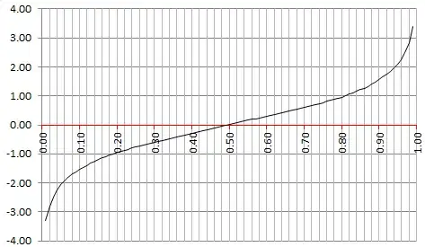

The empirical percentile distribution of $Z$ is pictured below: enter image description here
