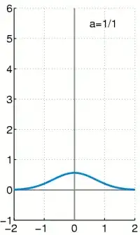

One semi-satisfactory rigorous way of dealing with the delta function (since there is no function that actually satisfies (1) and (2) above) is to create a sequence of functions $\delta_n$ like these ones:
The sequence $\delta_n(x)$ converges to $0$ for all $x\neq 0$, and the integral from $-\infty$ to $\infty$ of each $\delta_n$ is $1$. We then define $\int_a^b f(x)\delta(x)dx$ to be the limit of the expression $\int_a^b f(x)\delta_n(x)dx$ as $n\to\infty$, which can be shown to be $f(0)$ if $(a,b)$ contains $0$ and $0$ if $[a,b]$ doesn't contain $0$.
If you try to work out $\int_0^a\delta(x)dx$ then you get that
$$\int_0^a\delta_n(x)dx=\frac{1}{2}\int_{-a}^a\delta_n(x)dx\to\frac{1}{2}\textrm{ as }n\to\infty$$
