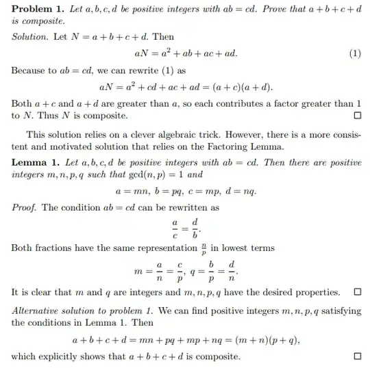

Since $a>b>c>d$, each of $a-b, a+b+c, c-d, c+d-b$ is positive. By factoring lemma (excerpted below) there exists $w, x, y, z \in \mathbb{Z}^+$ s.t.
$$a-b=wx, a+b+c=yz, c-d=wy, c+d-b=xz$$

Below is the linked "factoring lemma".
