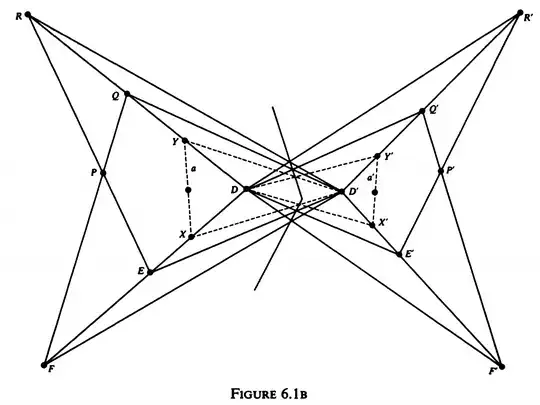

Coxeter, in his book Projective Geometry, writes about one and two dimensional projective mappings.
In the second edition, Theorem 4.12 is the fundamental theorem of one dimensional projectivities, and is the one to which you refer (projectivities determined by three points on each of two lines).
Theorem 6.13 is the fundamental theorem of (two-dimensional) projective collineations - basically that a projective transformation is determined by two complete quadrilaterals $DEFPQR$ and $D'E'F'P'Q'R'$. The correspondence between $DEF$ and $D'E'F'$ is like the correspondence that determines a 1D projectivity. But the extra correspondence between $DQR$ and $D'Q'R'$ adds more information. Altogether, it adds up to the usual determination of a projective transformation by specifying the mappings of four points.
The diagram below, from Coxeter's book, summarizes the synthetic construction for a projective collineation that maps a line $a=XY$ to $a'=X'Y'$. Here the construction for the 1D projectivity is used twice, once for each of $X \rightarrow X'$ (using $DEF\rightarrow D'E'F'$) and $Y \rightarrow Y'$ (using $DQR\rightarrow D'Q'R'$).

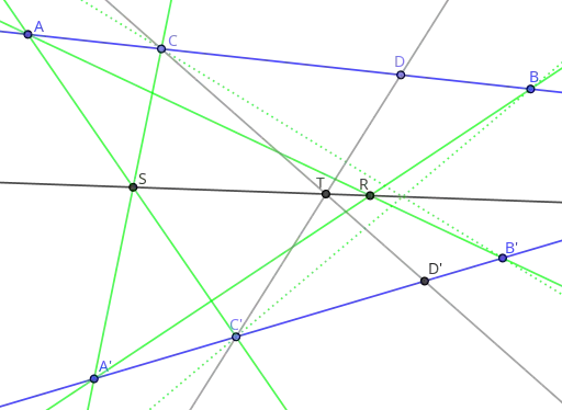

If you are looking for a straightedge-only construction of a cross-ratio-preserving map between the points of two lines, here is one. I call it Pappus-like because it uses the Pappus line.
Transferring crossratio
Given different lines $L,L'$ with pairwise distinct points $A,B,C$ on $L\setminus L'$ and pairwise distinct points $A',B',C'$ on $L'\setminus L$, first construct the Pappus line $\overline{RS}$ as shown above.
Then, given $D$ on $L$, construct $T$ as the point of intersection of $\overline{C'D}$ with $\overline{RS}$, then $D'$ as the point of intersection of $\overline{CT}$ with $L'$.
In the latter two steps you can use $(A,A')$ or $(B,B')$ in place of $(C,C')$; the result for $D'$ is the same as long as $D$ remains on $L$.
In particular, the resulting map $D\mapsto D'$ maps $A\mapsto A'$, $B\mapsto B'$ (using Pappus's theorem) and $C\mapsto C'$.
The proof that the cross-ratio of $A,B,C,D$ equals that of $A',B',C',D'$ is left as an exercise to you. Note that the transformation according to this recipe is singular because its image is constrained to $L'$. Therefore you cannot simply argue algebraically with the multiplicativity of determinants to deduce that cross-ratio is preserved. There are ways around that obstacle, but I prefer direct calculation using a homogenous coordinate system where $A,B,A',B'$ have coordinate tuples $(\pm 1:\pm 1:\pm 1)$.
