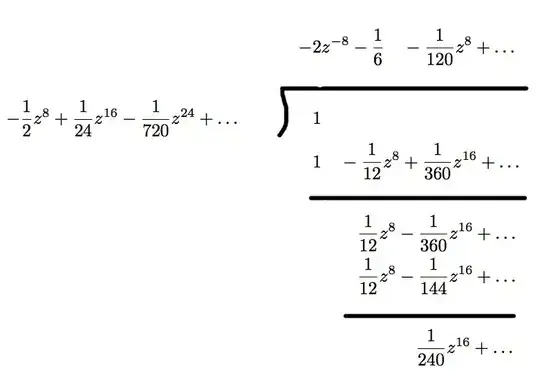

Long Division ... still worth learning
To get more terms in the quotient, use more terms in the divisor.

  • Thank you. While I understand the mechanics of the above division, I am unsure why it works, because for polynomial long division I'm accustomed to listing the polynomials in decreasing instead of increasing powers. I also don't know how the radius of convergence of a Laurent series obtained by division is related to that of the original Taylor series (in this case, the series in the denominator). – ryang Mar 27 '13 at 03:55

  • And you think computing the 8th derivative of $f(z)$ is easier than the long-division calculation above? – GEdgar Mar 27 '13 at 15:48
