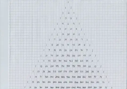

Actually, you can see in the triangle itself that there is a diagonal of odd numbers starting with the 1 in row $2^k$ and reaching row $2^{k+1} -1.$ So every row in between has such an odd entry, this being by simple propagation. Starting with row 4, diagonal odd entries: 1,5,15,35. Or, starting with row 8: 1,9,45, 165,495,1287,3003,6435.
On the same note, there is a diagonal of even numbers from row $2^k$ to $2^{k+1}-2.$ From row 4: 4,10,20. From row 8: 8,36,120,3309,792,1716,3432.
I guess you need to work out what happens at row $2^k$ and row $2^k - 1$ on your own. Life is a never ending quest for renewal. However, you can certainly do it by Legendre's theorem for $\mbox{ord}_2 (n!)$ using a sum of floor functions, in the case that $n = 2^k.$ Then the fact that row $2^k -1$ are all odd is just induction.
EDIT: I see, @Thomas gives a very simple answer for row $2^m,$ so there you go.
