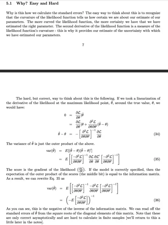

I am faced to a problem of demonstration, about Maximum Likelihood Estimation, summarized on this image :
Issue for demonstration
Indeed, I don't know how to prove the following equality between :
(1)
$$\begin{aligned} \operatorname{var}(\hat{\theta}) &=E\left[(\hat{\theta}-\theta)(\hat{\theta}-\theta)^{\prime}\right] \\ &=E\left[\left[\frac{-\partial^{2} \mathcal{L}}{\partial \theta \partial \theta^{\prime}}\right]^{-1} \frac{\partial \mathcal{L}}{\partial \theta} \frac{\partial \mathcal{L}^{\prime}}{\partial \theta}\left[\frac{-\partial^{2} \mathcal{L}}{\partial \theta \partial \theta^{\prime}}\right]^{-1}\right] \end{aligned}$$
(2)
$$\begin{aligned} \operatorname{var}(\hat{\theta}) &=E\left[\left[\frac{-\partial^{2} \mathcal{L}}{\partial \theta \partial \theta^{\prime}}\right]^{-1} \frac{-\partial^{2} \mathcal{L}}{\partial \theta \partial \theta^{\prime}}\left[\frac{-\partial^{2} \mathcal{L}}{\partial \theta \partial \theta^{\prime}}\right]^{-1}\right] \\ &=\left(-E\left[\frac{-\partial^{2} \mathcal{L}}{\partial \theta \partial \theta^{\prime}}\right]\right)^{-1} \end{aligned}$$
Equality between (1) and (2) suppose that :
$$\frac{\partial \mathcal{L}}{\partial \theta} \frac{\partial \mathcal{L}^{\prime}}{\partial \theta}=\frac{-\partial^{2} \mathcal{L}}{\partial \theta \partial \theta^{\prime}}$$
This is the equality I would like to prove.
1) Is there an approximation between both ? not just an equality ?
It is said that "If the model is correctly specified, then the expectation of the outer product of the scores (the middle bit) is equal to the information matrix" :
2) What does "if the model is correctly specified" mean ?
Maybe a Taylor development could help me to prove this equality but for now, I can't manage to prove it...

    What does $\cal L'$ mean (with the dash)? – TheSimpliFire Nov 24 '19 at 10:18
  • @TheSimpleFire : $\cal L'$ correponds to the Likelihood of parameter $\theta'$ and $\cal L$ to the Likelihood of $\theta$. You can see on $eq(34)$ at the beginning. –  Nov 24 '19 at 14:07
    But surely $\cal L=L'$. Should it not be $\frac{\partial\cal L}{\partial \theta}\frac{\partial\cal L}{\partial\theta'}$? And how are $\theta$ and $\theta'$ related? – TheSimpliFire Nov 24 '19 at 14:09
  • @TheSimpliFire, not exactly, I have to demonstrate that : $\frac{\partial \mathcal{L}}{\partial \theta} \frac{\partial \mathcal{L}^{\prime}}{\partial \theta}=\frac{-\partial^{2} \mathcal{L}}{\partial \theta \partial \theta^{\prime}}$ –  Nov 24 '19 at 14:10
    If $\theta,\theta'$ come from the same p.d.f. then the likelihoods $\cal L$ and $\cal L'$ are the same irrespective of the parameter. E.g. for a normal distribution the parameters are $\mu$ and $\sigma^2$ but the likelihood function is still $\mathcal L(\mu,\sigma^2\mid x)=\frac1{(2\pi\sigma^2)^{n/2}}\exp\left(-\frac1{2\sigma^2}\sum\limits_{i=1}^n(x_i-\mu)^2\right)$. – TheSimpliFire Nov 24 '19 at 14:14
  • But why they are using this development : $\begin{aligned} 0 &=\frac{\partial \mathcal{L}}{\partial \theta} | \hat{\theta} \ &=\frac{\partial \mathcal{L}}{\partial \theta} | \theta+\frac{\partial^{2} \mathcal{L}}{\partial \theta \partial \theta^{\prime}}(\hat{\theta}-\theta) \ \hat{\theta}-\theta &=-\left[\frac{\partial^{2} \mathcal{L}}{\partial \theta \partial \theta^{\prime}}\right]^{-1} \frac{\partial \mathcal{L}}{\partial \theta} \end{aligned}$ ? Is it not correct ? –  Nov 24 '19 at 14:22
    The notes form which this is taken do not seem very well written (there are multiple issues, not just what you have quoted). You should probably look for a better text. – Max Nov 26 '19 at 12:12
  • @Max . I didn't think that following equality : $\frac{\partial \mathcal{L}}{\partial \theta} \frac{\partial \mathcal{L}^{\prime}}{\partial \theta}=\frac{-\partial^{2} \mathcal{L}}{\partial \theta \partial \theta^{\prime}}$ would be so hard to demonstrate. Could you give please other references where there aren't multiples issues compared to my source at the beginning of my post ? Regards –  Nov 26 '19 at 16:22
