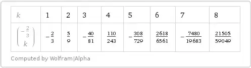

Let $\ v=c-u,$ then $$I=\int\limits_{c-b}^{c-a}\dfrac{\sin(c-v)\,\mathrm dv}{\sqrt[3]{(v-\sin(c-v))^2}} = \int\limits_{c-b}^{c-a}\dfrac{\sin(c-v)v^{\mathbf-{\large 2\over3}\,\mathrm dv}}{\left(1-\dfrac{\sin(c-v)}v\right)^{\large 2\over3}},$$ $$I = \int\limits_{c-b}^{c-a} S(c,v)\,\mathrm dv,\tag1$$ where $$S(c,v) = \sum\limits_{k=0}^\infty(-1)^k\dbinom{-2/3}{k}\sin^{k+1}(c-v)\,v^{^{\Large -\frac{3k+2}3}},\tag2$$ $$\dbinom{-2/3}{k} = \dfrac1{k!}\dfrac{\Gamma\left(\dfrac13\right)}{\Gamma\left(\dfrac13-k\right)} = {(-1)}^k\cdot1\cdot\dfrac23\cdot\dfrac56\cdot\dfrac89\dots\dfrac{3k-1}{3k},\tag3$$
Binom -2/3
