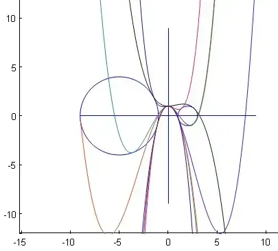

Here is a method giving all solutions in a deterministic way.
Take a look at the following figure :
Fig. 1 : The exhaustive set of 8 solution curves in the case $a=1, \ b=1, \ R_L=3, \ R_R=1$. Please note that some tangencies are internal to the circles.
How has this result been obtained ? By using a Computer Algebra System with a rather simple system of 4 polynomial equations in the 4 unknowns $c,d,x_L,x_R$ where (your notations) the two last parameters are the abscissas of the tangency points of the cubic curve with equation
$$y=f(x)=b+cx^2+dx^3$$
with the Left and Right circle resp.
Here they are:
$$\begin{cases}(x_L+R_L+a)^2+f(x_L)^2&=&R_L^2& \ \ (i)\\ (x_R-R_R-a)^2+f(x_R)^2&=&R_R^2& \ \ (ii)\\ \dfrac{f(x_L)}{x_L+R_L+a}&=&- \dfrac{1}{f'(x_L)}& \ \ (iii)\\ \dfrac{f(x_R)}{x_R-R_R-a}&=&- \dfrac{1}{f'(x_R)}& \ \ (iv)\\ \end{cases}\tag{1}$$
The first two equations express that $M_L=(x_L,f(x_L))$ and $M_R=(x_R,f(x_R))$ belong to their resp. circles.
Let us now explain the third equation. Let $C_L(-(R_L+a),0)$ denotes the center of the first circle. The slope of the tangent in $M_L$ is $f'(x_L)$. $\vec{C_LM_L}=\binom{x_L+R_L+a}{f(x_L)-0}$, being orthogonal to this tangent, has a slope $-\dfrac{1}{f'(x_L)}$ (see there). Similar reasoning for the fourth equation.

1) I haven't found the limitations you mention in the case of a large gap between $R_L$ and $R_R$. For example when $R_L=100$ and $R_R=1$, (with $a=1$ and $b=0$), one finds 14 solutions...
2) The third equation can be written : $f(x_L)f'(x_L)+x_L+R_L+a=0$ : this avoids possible division by zero. Same thing for the fourth equation.
Another case (Fig. 2), this time with $R_L=R_R$ displaying some spurious solutions under the form of ... second degree curves, i.e., parabolas (one can indeed have $d=0$) :
Fig. 2.
Still another case, with four solutions (one of them looks to be a parabola but isn't):
Fig. 3.
Here is the Matlab program that has given figure 1
(running time : around 30 seconds on my rather slow computer). Please note the "isreal" conditions (we want the different unknowns to be real) : in fact in the first case, there are $40$ solutions, $32$ of them being spurious, i.e., with complex coefficients...
Final remark : In fact, there exists a different way to solve system (1) by doing it in two steps ; first, by expressing the fact that equations (i) and (iii) have a common root $x_L$ giving (using a "resultant" ) a first (non-linear) constraint between $c$ and $d$. Doing the same for equations (ii) and (iv) for common root $x_R$, gives a second constraint. Then, in a second step, solve the system of 2 (non-linear...) equations in 2 unknowns $c$ and $d$.
