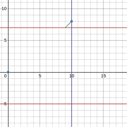

Suppose we are looking at all paths from $(0,0)$ to $(N,r)$ using only the steps $(1,\pm 1)$ while always staying between the horizontals $y=r-1$ (except for the last step) and $y=-l$.
Visualization: enter image description here
Roughly speaking, I am looking at all paths consisting only of unit diagonals up/down between the two blue points while always staying between the two horizontal lines. The green line indicates the last step, which is the only possible last step since we have to stay below the red line in all prior steps.
My question. How many such paths are there for any given $N,l$ and $r$?

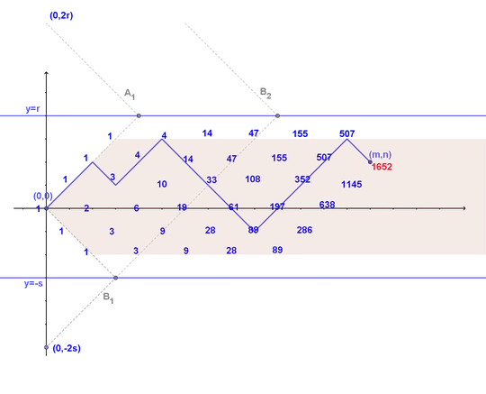

Example:
Now it's time to harvest. So, let's make an example which can also be easily manually checked. We look for the number of paths from $(0,0)$ to $(14,2)$ which do not reach the boundary lines $y=4$ and $y=-3$.
This number is $\color{blue}{L_{14,2;4,3}=1\,652}$ which is marked red in the graphic below.
![enter image description here
Applying (1) we obtain \begin{align*} \color{blue}{L_{14,2;4,3}}&=\binom{14}{8}-\sum_{j\geq0}\left[\binom{14}{8-4(j+1)-3j} +\binom{14}{8+4j+3(j+1)}\right]\\ &\qquad\qquad\qquad+\sum_{j\geq1}\left[\binom{14}{8+7j} +\binom{14}{8-7j}\right]\\ &=\binom{14}{8}-\left[\binom{14}{4}+\binom{14}{11}\right]+\left[\binom{14}{1}\right]\tag{12}\\ &=3\,003-\left(1\,001+364\right)+\left(14\right)\\ &\,\,\color{blue}{=1\,652} \end{align*}
in accordance with the manual calculation in the graphic.
  • In (12) we have two summands in brackets. They give the number of reflected paths indicated in the graphic via $A_1$ and $B_1$.
  • The right-most summand in (12) gives the number of reflected paths indicated in the graphic via $B_2$.
  • No more reflections need to be considered in this example.
