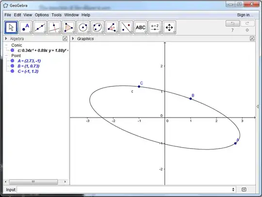

Example
Consider the points $(\sqrt{3}+1,-1)$, $(1,\sqrt{3}-1)$ and $(-1,\frac{5 \sqrt{3}}{13} + \frac{7}{13})$
Find the coefficients $$\begin{pmatrix} C_{11} \\ C_{22} \\ C_{12} \end{pmatrix} = \begin{pmatrix} \frac{5-2\sqrt{3}}{9} \\ \frac{2 \sqrt{3}+5}{9} \\ \frac{2}{9} \end{pmatrix} $$
Find the angle $$\theta = \frac{1}{2} \arctan \left( \frac{1}{\sqrt{3}} \right) = \frac{\pi}{12}$$
Find the axes:
  • $\eta = \frac{10}{9}$
  • $\zeta = \frac{8}{9}$
  • $a^2 = \frac{2}{\frac{2}{9}}= 9$
  • $b^2 = \frac{2}{2} = 1$
Find the ellipse equation
$$ \left( \frac{5}{9} - \frac{2 \sqrt{3}}{9} \right) x^2 + \left( \frac{2 \sqrt{3}}{9} + \frac{5}{9} \right) + \frac{4}{9} x y - 1 =0 $$
Confirm results with GeoGebra:

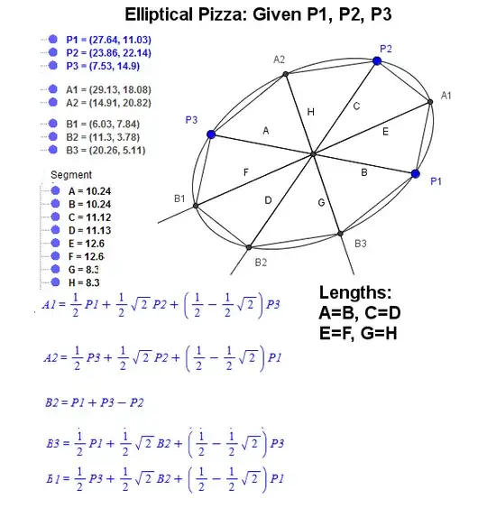

I think I found an answer, you don't need to know the center but you have to know which 3 points on the diagram you know, I called it the
Elliptical Pizza
, once you find 2 additional points using the formulas you find the conic through 5 points as here Conic through 5 points...
I posted it on my blog here: Elliptical Pizza on Ben Paul Thurston Blog
