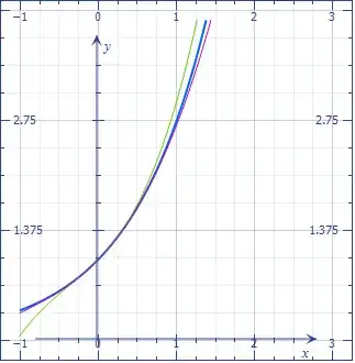

The plot shows
$$x-\frac{x^3}6<\sin x<x-\frac{x^3}6+\frac{x^5}{120}$$
Of course this matches the terms of Taylor's expansion, but without explicitly using the theorem.
