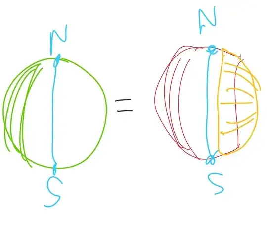

If $X$ is the union of $S^2$ and the diameter between the North and South poles. Calculating $\pi_{1}(X)$ using Van Kampen theorem.
Could anyone give me a hint about the open sets I should use?

    $X$ is homotopy equivalent to the wedge sum of $S^1$ and $S^2$. – Ayman Hourieh Oct 03 '19 at 16:50
  • @AymanHourieh can I take the open sets the northern hemisphere but slightly extending it below the equator (U) and the southern hemisphere but slightly extending it above the equator (V) ? – Intuition Oct 03 '19 at 17:42

In the figure, the space $X$ is given by the green ball with the blue line on the left. Now I let $U$ be the red shell and the blue line on the right, and $V$ the orange shell. Observe that $U$ is homotopic to $S^1$ and $V$ is contractible, while $U\cap V$ is homotopic to $S^1$. By van Kampen's theorem, $$\pi_1(X)\cong \pi_1(U)\underset{\pi_1(U\cap V)}{*}\pi_1(V).$$ But since any loop in $U\cap V$ is null-homotopic in $U$, the map $\pi_1(U\cap V)\to \pi_1(U)$ is trivial (the map $\pi_1(U\cap V)\to \pi_1(V)$ is also trivial because $\pi_1(V)$ is trivial), so $$\pi_1(X)\cong \big(\pi_1(U)*\pi_1(V)\big)/\{1\}\cong\big(\Bbb Z*\{1\}\big)/\{1\}\cong\Bbb Z/\{1\}\cong\Bbb Z.$$ Note that $\pi_1(X)$ is generated by a loop $g$ that passes through the diameter $NS$ exactly once.
