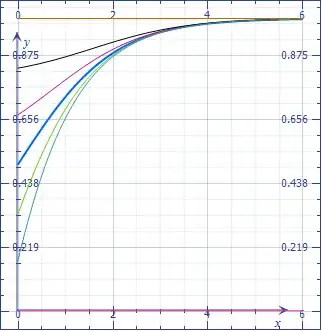

WLOG, $M=1$ and $k=1$ (normalize $P$ and $t$). The equation is separable. We assume $0\le P\le 1$.
$$\int_{P_0}^P\frac{dP}{(1-P)P}=\left.\log\frac P{1-P}\right|_{P_0}^P=t$$
and from this
$$P=\frac{P_0e^t}{P_0(e^t-1)+1}=1-\frac{1-P_0}{P_0(e^t-1)+1}.$$
Note that $P=0$ and $P=1$ are also solutions.
A few of them:
