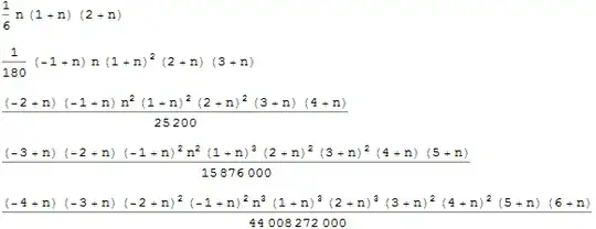

Update: Let us denote: \begin{eqnarray} {\mathcal S}_d^{(n)} := \sum\limits_{0 \le i_1 < i_2 < \cdots < i_d \le n} \prod\limits_{1 \le p < q \le d} (i_q-i_p) \end{eqnarray} for $n \ge d-1$. Then my conjecture is the following: \begin{eqnarray} {\mathcal S}_d^{(n)} = \left[\prod\limits_{\xi=1}^{d-1} \frac{(\xi!)^2}{(2 \xi+1)!}\right] \cdot \left[\prod\limits_{j=-d+1}^1 (n+j)^{\lceil \frac{j+d-1}{2} \rceil}\right] \cdot (n+2)^{\lfloor \frac{d}{2}\rfloor} \cdot \left[\prod\limits_{j=3}^d (n+j)^{\lceil \frac{d-j+1}{2} \rceil }\right] \end{eqnarray}
I have verified this conjecture for $d \le 6$ using the code below:

    @darij grinberg It is indeed quite remarkable that this factorizes so nicely. I have updated my answer and provided a Mathematica code that computes the sum for higher values of $d$. By the way , why are you interested in this very problem ? – Przemo Oct 07 '19 at 11:54
    I care partly because the sum is the sum of all maximal minors of the Vandermonde-like rectangular matrix $\left(i^{j-1}\right)_{1\leq i\leq n,\ 1\leq j\leq d}$, and it appears that there may be a more general determinant identity behind it. Also, the sum can be reinterpreted as counting something like Gelfand-Tsetlin patterns, since each $i_q - i_p$ factor can be viewed as choosing an integer from the interval $\left[i_p,i_q\right)$. These are not quite Gelfand-Tsetlin patterns, because all these integers in a given addend of the sum are independent, but close enough to be interesting to me. – darij grinberg Oct 07 '19 at 13:18
  • Not a proven answer, but getting the exponents figured out is well worth the bounty. Congrats! – darij grinberg Oct 10 '19 at 00:26
  • This is obvious from the context but just wanted to make sure: the second \prod in (2) should run from $p=1$ to $d-1$. I am still unable to prove the last equality (with question mark) for $c_{d}$. Posted in MathOverflow with links to this page. – Abhishek Halder Nov 04 '19 at 17:35
