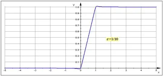

Your function can be approximated through two shifted ramp functions, as $$ \eqalign{ & f(x) = x\,H(x) - \left( {x - 1} \right)\,H(x - 1) \approx \cr & \approx {x \over 2}\left( {1 + {x \over {\sqrt {x^{\,2} + \varepsilon ^{\,2} } }}} \right) - {{\left( {x - 1} \right)} \over 2}\left( {1 + {{\left( {x - 1} \right)} \over {\sqrt {{\left( {x - 1} \right)}^{\,2} + \varepsilon ^{\,2} } }}} \right) \cr} $$ where
$H(x)$ denotes the Heaviside step function;
$\varepsilon <<1$ is a small value.
Concerning the square root, you might calculate itrecursively through the famous Babylonian Method
This is an example of what you get with $\varepsilon = 0.1$.
Intp_Rampa_1
It is clear that operating around the symmetric function $ x-1/2 \to y-1/2$ you can reduce the computations almost in half.

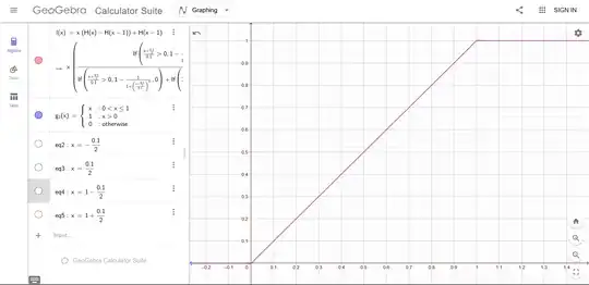

For my current research, I needed a smooth(ish) approximation to the Heaviside step function defined on a compact interval. I really wanted to use a similar approach to the one discussed in chapter 13 of the book "An Introduction to Manifolds" by Loring W. Tu. This approach uses the function $$f(x)=\left\{\begin{array}{cc}e^{-\frac{1}{x}},&x>0,\\0,&x\le0\end{array}\right.$$ to construct a $C^\infty$ bump function. When I tried implementing this numerically I ran into some problems due to the very fast nature of how this function approaches $0$ (overflow errors, division by zero, etc. ).
This led me to an approach that is extremely similar to that used in the book but instead of using the function $e^{-\frac{1}{x}}$, I needed to find a function with the same basic ''shape'' and behavior as the exponential but which was simpler to compute and used only addition/subtraction, multiplication/division (and was perhaps not $C^\infty$ but just $C^1$ or $C^2$). I thought for a while and finally decided to use the function
$$f(x)=\left\{\begin{array}{cc}1-\frac{1}{1+x^p},&x>0,\\0,&x\le0\end{array}\right.$$ where $p$ is a positive integer greater than or equal to 2.
To construct the Heaviside step function approximation from this you can simply follow a slightly altered version of the procedure in the book by Tu
Define $g(x)=\frac{f(x)}{f(x)+f(1-x)}$ and let $\epsilon$ be the desired width of the smoothed interval around the corner point (in the plots below I use $\epsilon=.1$)
The approximation to the Heaviside-step function is then given by $$H_\epsilon(x)=g\left(\frac{x-\frac{\epsilon}{2}}{\epsilon}\right)$$
Here is a comparison what Tu's Heaviside step function (red) and my Heaviside step function (purple) approximation look like for $p=2$ enter image description here
They look very similar and get sharper as you increase the value of $p$. As an added benefit, the function $f$ gains more degrees of smoothness as $p$ is increased.
When I apply this approximation to your desired function $x(H(x)-H(x-1))+H(x-1)$ for $\epsilon=.1$ and $p=4$ the result is visually indistinguishable from the desired result. Actual function (blue), My approximation (red) enter image description here
I hope this helps you out! Please let me know if you have any questions regarding my approach
