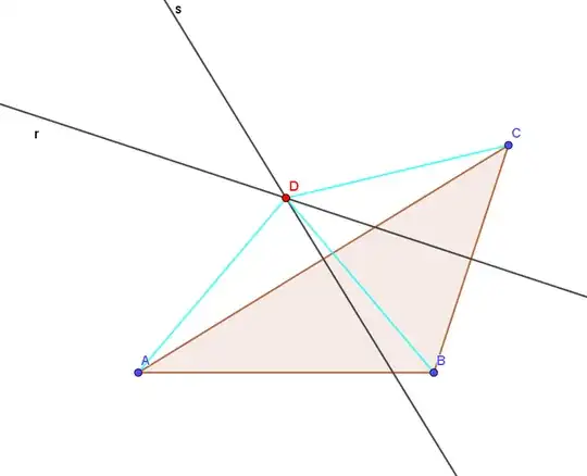

Let be $D$ the intersection point of the perpendicular bisectors of $AC$ and $BC$. You have that
  1. $AD=CD$ since $D$ belongs to $s$
  2. $CD=BD$ since $D$ belongs to $r$ Therefore $AD=BD=CD=R $ and the circle of center $D$ and radius $R$ is the required circle.
