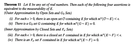

EDIT:
I have taken this theorem:
So what can I do after using (iii) in this theorem as a given?

Hint: For any measurable set $A$ of finite measure, the measure of $A$ is the supremum of the measures of closed sets contained in $A$. Use this to show that for any measurable $A$ (maybe of infinite measure) and $n$, there is a closed $F\subseteq A$ such that $A\setminus F$ has measure smaller than $1/n$.

  • I have edited my question please check it .... so your hint will be the Borel set? what about the set of measure zero? – Intuition Sep 09 '19 at 23:29
  • @hopefully: If you take the theorem you cited for granted, then this is immediate by (iv). – tomasz Sep 10 '19 at 01:02
  • And why $F_{\sigma}$ is considered as a Borel set? – Intuition Sep 10 '19 at 01:06
  • @hopefully Borel sets are a $\sigma$-algebra containing the open sets, hence closed sets are Borel, and countable unions ($F_\sigma$) of closed sets are Borel. –  Sep 10 '19 at 01:10
  • got it Thank you very much ...... so the solution is much easier than what is stated in the link above – Intuition Sep 10 '19 at 01:16
