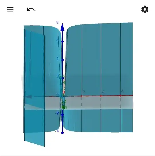

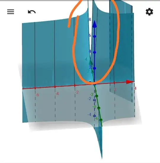

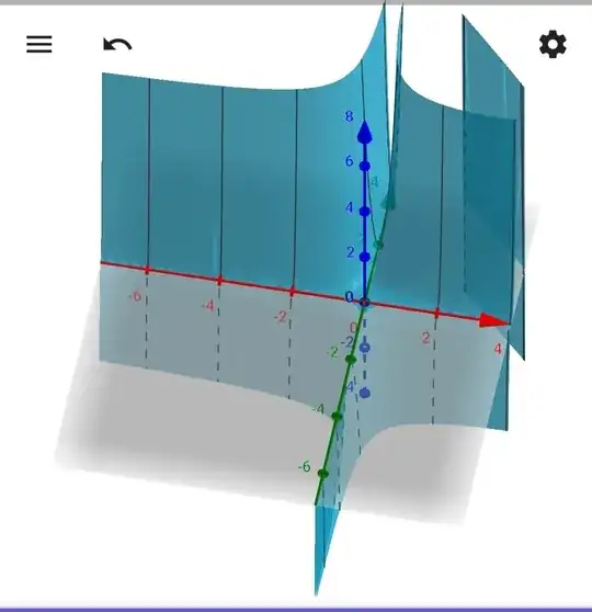

Yes, your calculations were correct
If you see graph of this equation you would see that (0,y) are points of inflection where (X,0)are minimum points. Like sine and cosine have multiple stationary points this graph too have infinite minimum points (X,0)
enter image description here enter image description hereenter image description here
Who am I
  • 915
  • But this function does not have minimum. – Marco Lecci Sep 05 '19 at 07:45
  • Can you elaborate on that? Because I am stuck on hessian matrix. I have calculated $f_{xx}$, $f_{xy}$, $f_{yx}$ and $f_{yy}$ and only stationary point that I know how to handle is $P_3$. – Kasata Ata Sep 05 '19 at 07:46
  • See, the graph does have minimum points – Who am I Sep 05 '19 at 07:50
  • Graph is perfectly fine, but how to handle such situation arithmetically? In the case of casual points, with known $x$ and $y$, the only thing I have to do is to substitute variables with coordinates in hessian matrix. How should I act with something like $(x, 0)$? – Kasata Ata Sep 05 '19 at 07:52
  • Input 0 in place of y and X in place of X. Tell me the result u get – Who am I Sep 05 '19 at 07:56
