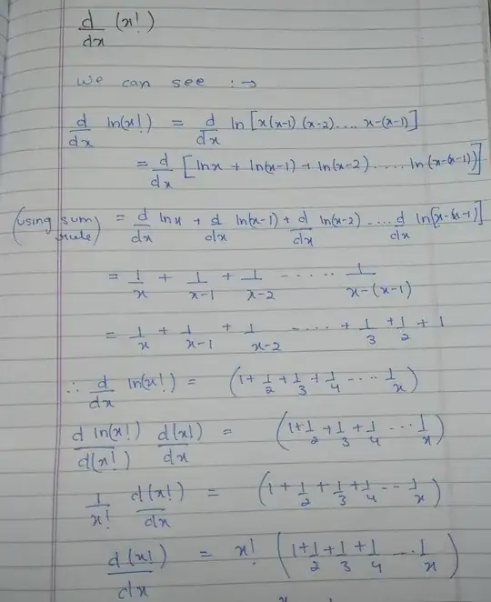

I was curious to find the derivative of $x!$ and tried it myself on a basic level.
This is what I tried :- enter image description here (Please forgive me for not writing it in text I am bit slow in that and lazy too!)

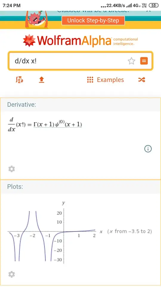

My question is whether this answer is correct or not since i find answers which are really beyond my knowledge:- enter image description here
Please help me figuring out whether my answer is correct or not and if correct then why wolfram shows such answer. (I am student and have no idea about those functions) Thanks!

The big problem with your answer is that you are working with the factorial function defined on the natural numbers. Such a function can't be differentiated so easily, as the standard definition of a derivative at a point requires the function to be defined in some open neighbourhood of that point. What wolfram alpha, and other sources I assume, are showing you is the derivative of the canonical extension of the factorial function to (most) of $\mathbb{R}$, the Gamma function.
