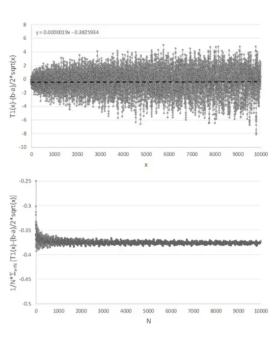

EDIT (after Mathworker21's answer): A rough numerical computation until $N=10000$ for the case $a=0.5$, $b=1$ seems to confirm the above estimates obtained with $N$ up to $2500$. Here is the plot of the differences $T_1(x)- \frac{b-a}{2} \sqrt{x}$ versus $x$, followed by that of the average value of these differences calculated over the first $N$ integers. As show in this second plot, $K_1(0.5,1)$ seems to converge to $\approx -0.37$. The dotted black line in the first graph is the best fitting line, whose intercept is compatible with such value. Based on a visual assessment, large departures from this value (as suggested by the provided answer) for higher $N$ seem unlikely: enter image description here

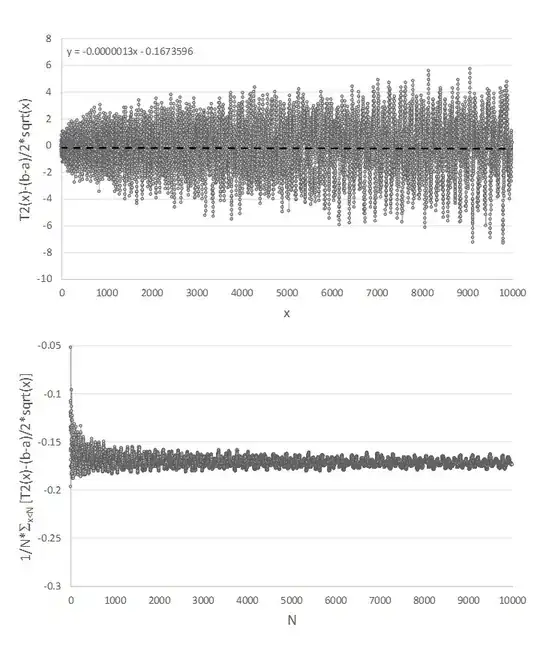

Similar considerations can be made for $K_2(0.5,1)$, which seems to converge to $\approx -0.17$: enter image description here
