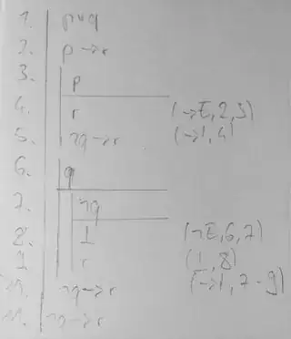

A proof of $p \lor q, p \to r \vdash \neg q \to r$ looks something like this:
(natural deduction, Fitch (= linear) style)

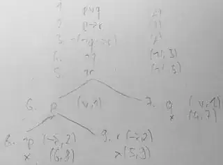

or this:
(tableau/truth tree)

$\Sigma \vdash \Delta$ means that $\Delta$ is derivable from $\Sigma$ in some syntactic proof system. By "syntactic" we man a system purely operating on a set of rules that manipulate strings of symbols, without talking about semantic notations such as assignment, truth, model or interpretation. A syntactic proof system is one that says, for example, "If you have A written on one line and B on another line, then you are allowed to write the symbols A∧B on a line below that." Examples of syntactic proof systems are Hilbert-style calculi, sequent calculi and natural deduction in their various flavors or Beth tableaus aka truth trees. As you see in the three pictures above, at no point did we make explicit reference to things such as truth, assignment, interpretation: This is why it's called "syntactic": The rules only need strings of symbols in order to be applied, not their semantics (at least not explicitly). If we do a natural deduction, a tableau, a Hilbert-style proof, ..., then we talk about $\vdash$.
