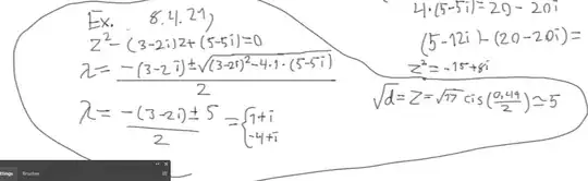

I am reading a book and current I am doing some exercises. The exercise that I am having trouble with is this:
Solve the following equation for $z$:
$z^2-(3-2i)z+(5-5i)=0$
I know that the solution is $2+i$ and $1-3i$ but I do not know the steps to get to this result. I have tried using the polar form of complex number to calculate the roots using the solution formula for quadratic equations. However, what I get is not even near the correct results :/
So if anyone could give a user-friendly walkthrough of how to solve that quadratic polynomial - I would be very very happy!
Oh, and here is my general results, if you manage to read it :P

Hint
You had the correct idea but you did the square root wrong.
$$\sqrt{(3-2i)^2-4(5-5i)}\ne 5$$
in fact,
$$\sqrt{(3-2i)^2-4(5-5i)}=\sqrt{-15+8i}=a+bi$$ with, $a,b \in \Bbb R$, so, $$(a+bi)^2=-15+8i$$
solve the above equation and get your result.

The OP made two errors in the exercise:
  1. As the quadratic formula is $\lambda= \dfrac{-b \pm \sqrt{b^2-4ac}}{2a}$, the $-(3-2i)$ should be replaced by $(3-2i)$ for $-b$.
  2. The calculation of $\Delta=b^2-4ac$ is incorrect.
We have
$$\Delta =b^2-4ac=(3-2i)^2-4(1)(5-5i)=(5-12i)-(20+20i)=-15+8i$$
so that
$$\lambda=\frac{3-2i\pm \sqrt{-15+8i}}{2}$$
where we can find the square roots $\pm (a+bi)$ of $-15+8i$ by solving the equation
$$(a+ib)^2=-15+8i$$
We have that $(1+4i)^2=-15+8i$, hence the two square roots are $\pm(1+4i).$ Therefore
$$\lambda=\frac{3-2i + (1+4i)}{2}=2+i$$
or
$$\lambda=\frac{3-2i - (1+4i)}{2}=1-3i$$
