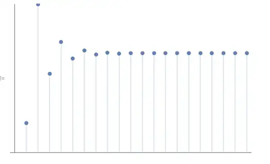

Using Mathematica, I found that both of the sequences $(x_n)_{n \in \mathbb N}$ and $(z_n)_{n \in \mathbb N}$ share the same plot as follows.
I would like to ask whether it is possible to utilize the convergence of $(z_n)_{n \in \mathbb N}$ to prove the convergence of $(x_n)_{n \in \mathbb N}$.
