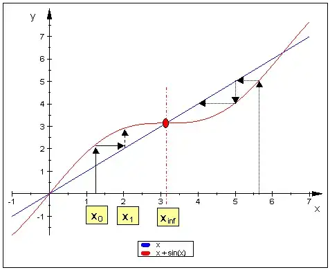

Have a look at this related post where it is shown that the sequence $$ \begin{cases} x_{0} = c & \\ x_{n} = x_{n - 1} + \sin (x_{n - 1} ) & \end{cases} $$ graphically translates into the following picture sin@sin_2
Have a look there to see the conclusion about the attractor points being $\pi +2k \pi$
