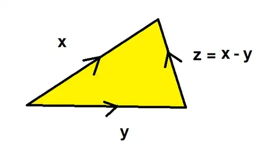

A proof by vectors enter image description here
$$|\vec z|^2 = |\vec x- \vec y|^2 = (\vec x - \vec y) \cdot (\vec x - \vec y) = |\vec x| ^2 + |\vec y|^2 - 2|\vec x \vec y | \le |\vec x|^2 -2|\vec x|\|\vec y| + |\vec y|^2 = (|\vec x| -|\vec y| )^2$$
$$\text{ or } |\vec x - \vec y| \le ||\vec x| - |\vec y||$$
If $\vec{x}$ and $\vec{y}$ are along the same direction, then we may simply write $\vec x \equiv x$ and $\vec y \equiv y$
Thus,
$$|x-y| \le ||x| - |y||$$
19aksh
  • 12,835
  • Shouldn't you write $\left|\vec{x}-\vec{y}\right|\cdot\left|\vec{x}-\vec{y}\right|$ instead of $(\vec{x}-\vec{y})\cdot(\vec{x}-\vec{y})$? – HERO Aug 03 '19 at 08:55
  • @AmandaMacaurenni The dot product : $$\vec{a}\cdot\vec{a} = |\vec{a}||\vec{a}|\cos0 = |\vec{a}||\vec{a}|$$ . So both are equivalent. – 19aksh Aug 03 '19 at 09:10
