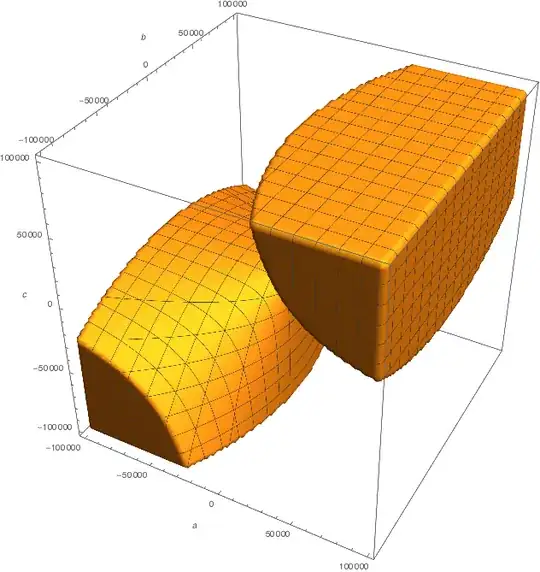

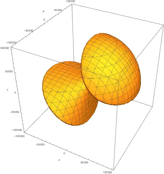

It's helpful to think of each quadratic polynomial as corresponding to a point in "coefficient space", an abstract 3D space whose coordinates are $(a,b,c)$. The question "What fraction of quadratic polynomials have no $x$-intercept?" can then be rephrased as "What fraction of coefficient space lies in the region $b^2 < 4 a c$?"
The problem is, of course, that this "coefficient space" has an infinite volume: $a$, $b$, or $c$ can be arbitrarily large. What's more, the region of coefficient space corresponding to polynomials without intercepts is also infinitely large: for any polynomial without an $x$-intercept, you can multiply it by any real number and get another polynomial without an $x$-intercept. And if mathematics has taught us anything, it's that if we try to divide ∞ by ∞ we cannot expect a meaningful result.
You can, however, place bounds on the values of $a$, $b$, and $c$, so that these volumes of "coefficient space" are finite. In your code, you picked the quantities $(a, b, c)$ with uniform probability from the range $(-10^5, 10^5)$. This corresponds to the region of coefficient space below:
Mathematica (which I used to make this plot), tells me that the fraction of this cube that is filled is $$ \frac{31 - 6 \ln 2}{72} = 0.3727932905... \neq \frac{3}{8}. $$ So the ratio you found "experimentally" is not actually equal to 3/8, but it's pretty close.
On the other hand, you could have also decided to pick all your coefficients such that $a^2 + b^2 + c^2 < (10^5)^2$. This would correspond to allowing $a$, $b$, and $c$ to lie in some spherical region of "coefficient space". Spheres are nice, right? Everybody likes spheres.
The fraction of this region out of the allowed spherical volume in coefficient space is (again, relying on Mathematica) is only about 0.3514..., noticeably less than 3/8. The region of coefficients you allow, and how you parametrize them, turns out to make a difference in what your final answer is (which is what some of the other answers are trying to point out.)

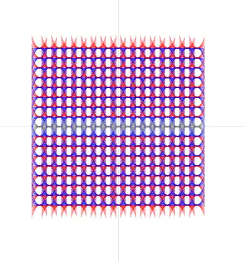

Other answers have done a good job at showing this mathematically, but I feel that a bit of visual explanation would help to solidify exactly why there is a difference in these two answers of $1/2$ and ~$3/8$.
Below, I have made a graph of all quadratic equations of the form $a(x-b)^2 +c$, for every combination of $a$, $b$ and $c$ in the closed interval $[-4,4]$, with a step size of $0.5$. The exact numbers are not relevant to this answer (though it is relevant to say that the x-scale and y-scale are equal, and both are linear).
For each parabola, I've only plotted a small section near the vertex. The line of each is colored according to how many x-intercepts it has: 0 is red, 1 is grey, and 2 is blue.
graph of the search space for a(x-b)^2 +c
A visual inspection reveals that there is roughly an equal number of red and blue parabolas, and both vastly outnumber the grey ones. The exact counts in this graph are:
$$ \begin{matrix} \color{blue}{\text{Two}} & 2448 & 0.4982699 \\ \color{gray}{\text{One}} & 289 & 0.05882353 \\ \color{red}{\text{Zero}} & 2176 & 0.4429066 \\ \end{matrix} $$

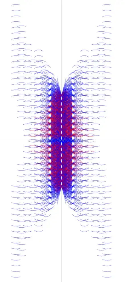

Now, let's look at the same search space, but using the form $ax^2 +bx+c$. The graph looks quite different:
graph of the search space for ax^2 +bx+c
Again the grey are outnumbered, but we see vastly more blue than red. The exact numbers here are:
$$ \begin{matrix} \color{blue}{\text{Two}} & 3104 & 0.6317932 \\ \color{gray}{\text{One}} & 65 & 0.0132302055 \\ \color{red}{\text{Zero}} & 1744 & 0.3549766 \\ \end{matrix} $$
As we can see, the 'wings' of this graph are exclusively blue, meaning that all such parabolas have two intercepts. This is what skews the result away from $1/2$.
For those interested, the language I used to generate these images was Processing, and the code may be found here: https://pastebin.com/geLya3jQ. (Why? Mostly because I don't have much experience with Mathematica, etc.)

$$V = \frac{8}{9} n^{3/2} n^{3/2} $$
This is the volume of one octant; the volume for the 4 octants is then
$$V = \frac{32}{9} n^{3} $$
The volume of the entire domain is $(2n)^3 = 8n^3$
Then the probability of having no x-intercept is
$$p=\frac{\frac{32}{9} n^{3}}{8n^3} = \frac{4}{9} $$
Note that the probability is independent of $n$.
xidgel
  • 459
    Note that we could have $2\sqrt{ac}>n$ even if $a \le n$ and $c \le n$. So your integral isn't computing the volume of the correct region, but of something bigger. Perhaps this is why you've come up with a larger fraction than the OP... – Micah Jul 29 '19 at 19:04
