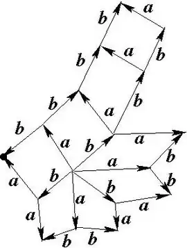

Let $G=\langle X; \mathbf{r}\rangle$ be a group given in terms of generators and relators. It is often useful to see what a word representing the identity element of the group will look like.
Write every relator on a circle. These are our tiles.
Let $W$ be a word over $X$ and write $W$ in around a circle. Then $W$ is equal to the trivial word if and only if $W$ can be "tiled" by the relators (this make sense as cyclic shifts (and, indeed, all conjugates) of $W$ are also equal to the identity).
This is a very powerful tool, and a snazzy way of visualising your groups. These are called van Kampen Diagrams, or just Diagrams. There is also a dual notion, called Pictures.
An excellent reference to this is the end of the book "Combinatorial group theory" by Lyndon and Schupp (the chapter on small cancellation theory). Another excellent, but more modern, reference is the lecture notes of Hamish Short, Diagrams and groups (but I am less familiar with these).
For example, look at the group presentation $\langle a, b; [a, b]\rangle$. Then a valid diagram is (from Wikipedia),
A sample diagram
Fixing a vertex on the boundary and reading clockwise around the boundary then the word you get is necessarily equal in the group to the trivial word.
Now, if these tiles have a certain structure (e.g. a small cancellation structure) then you get a solution to the word problem and the conjugacy problem (and sometimes even the isomorphism problem, but that is a very recent result and boils down to hyperbolic groups). For example, if there is no way of fitting less than four tiles around a given tile (this is called the $C(4)$ condition), and when tiling every (internal) vertex is adjacent to at least four tiles (this is called the $T(4)$ condition) then the word and conjugacy problems are soluble. There is also the $C^{\prime}(1/\lambda)$ condition, which is the most useful of all, which says roughly (badly! but I am running out of time...) that if you fit some tiles around any tile then they do not touch with less than $1/\lambda$ if their respective lengths.
Okay, so that is the two-dimensional version. You are tiling the surface of a disc. What if you were to tile a sphere? Well, this comes down to the second homology group of your presentation, and is related to asphericity. There is a chapter in a book about this by Steve Pride and Bill Bogely, and Pride had some "rather clever stuff" about this earlier, according to Martin Bridson. Also, Baumslag, Bridson, Miller and Short used the Bogely-Pride theory to prove some pretty awesome stuff about fibre products in their paper "Fibre products, non-positive curvature, and decision problems" (although they do not actually use diagrams in their paper (or, at least, I do no remember them doing so, and flicking through it I see no images of diagrams)).
Mark Sapir is a prolific writer of this stuff. He has a recent paper which uses them. Also look up his word with Victor Guba on Diagram Groups. These are groups which are the symmetries of diagrams. Thompson's group $F$ is one, so these are important!
