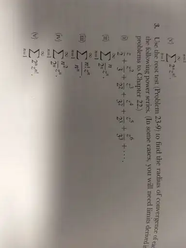

The chapter is about complex series and the question is to determine the radius of convergence using the root test:
Root test: the series $\sum_{n=1}^{\infty} a_{n}$ converges if $$\lim_{n \to \infty} (|a_{n}|)^{\frac{1}{n}}=r<1$$
The series to be determined is $$\sum_{n=1}^{\infty} \frac{n!z^{n}}{n^{n}}$$

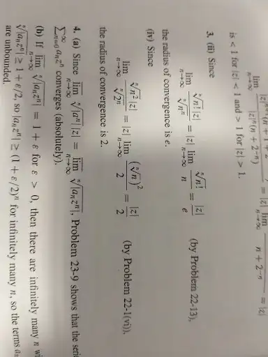

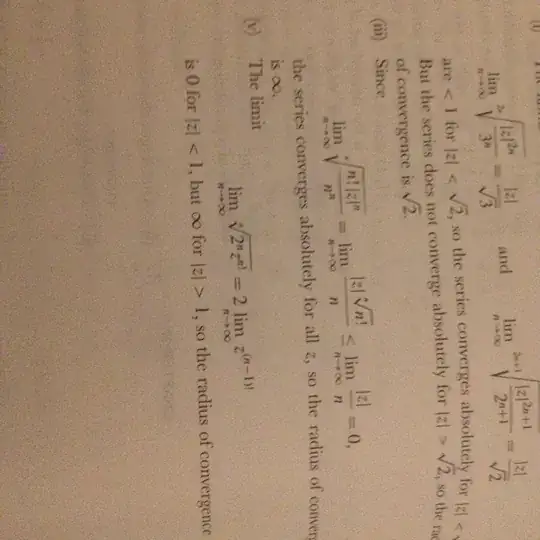

  • @dunham it is wierd because in the book this problem is labeled 3.(ii) however in the answers it is labeled 3.(iii). I have double checked to make sure they are talking about the same sum . I will add a picture of the solution in the book for reference –  Jul 24 '19 at 21:56

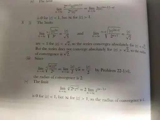

These are the revisions in the 4th edition:
Problem in the 4th edition:
Selected solutions in the 4th edition:
Answer book solution to 3rd and 4th editions:
