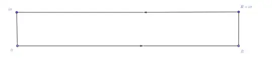

Fix now some $R>0$, and consider the rectangle contour $C(R)$ with corners, in order, $0,R,R+i\pi,i\pi$:
Computation of zeta values at positive even integers using the Residue Theorem
The integral of $f_4$ on $C(R)$ vanishes by the Residue Theorem. We let now $R\to+\infty$.
