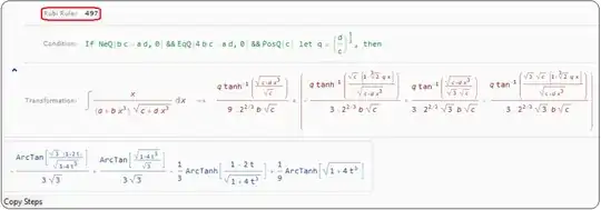

Given the function $f : (0,\,1) \to \mathbb{R}$ $$ f(x) := \frac{1}{\sqrt[3]{x\,(1 - x)}\left(1 - x(1 - x)\right)}\,, $$ we are interested in the calculation of $$ I := \int_0^1 f(x)\,\text{d}x\,. $$ First of all it is good to observe that: $$ f(1 - x) = f(x), \quad \forall \, x \in (0,\,1) $$ then: $$ I = 2 \int_0^{\frac{1}{2}} f(x)\,\text{d}x\,. $$ At this point, since: $$ f\left(\frac{1 - \sqrt{4\,t^3 + 1}}{2}\right) = -\frac{1}{t\left(t^3 + 1\right)}\,, \quad \quad \frac{\text{d}}{\text{d}t}\left(\frac{1 - \sqrt{4\,t^3 + 1}}{2}\right) = -\frac{3\,t^2}{\sqrt{4\,t^3 + 1}} $$ it follows that: $$ I = -6 \int_{-\frac{1}{\sqrt[3]{4}}}^0 \frac{t}{t^3 + 1}\,\frac{\text{d}t}{\sqrt{4\,t^3 + 1}}\,. $$ Now we can take advantage of the power of Rubi in Wolfram Mathematica:
PacletInstall["https://github.com/RuleBasedIntegration/Rubi/
               releases/download/4.16.1.0/Rubi-4.16.1.0.paclet"];
<< Rubi`
Steps@Int[t/((t^3 + 1) Sqrt[4 t^3 + 1]), t]
from which: $$ I = -6 \int_{-\frac{1}{\sqrt[3]{4}}}^0 \left[ \frac{2\,t - 1}{6\,(t + 1)\,\sqrt{4\,t^3 + 1}} + \frac{t^2}{2\left(t^3 + 1\right)\sqrt{4\,t^3 + 1}} - \\ \frac{2\,t^3 - 3\,t^2 - 1}{6\,t\left(t^2 - t + 1\right)\sqrt{4\,t^3 + 1}} - \frac{1}{6\,t\,\sqrt{4\,t^3 + 1}} \right]\text{d}t\,. $$ Hence a primitive in terms of elementary functions is: $$ I = -6\left[ - \frac{\arctan\left(\frac{\sqrt{3}\,(1 + 2\,t)}{\sqrt{4\,t^3 + 1}}\right)}{3\sqrt{3}} + \frac{\arctan\left(\frac{\sqrt{4\,t^3 + 1}}{\sqrt{3}}\right)}{3\sqrt{3}} - \\ \frac{1}{3}\,\text{arctanh}\left(\frac{1 - 2\,t}{\sqrt{4\,t^3 + 1}}\right) + \frac{1}{9}\,\text{arctanh}\left(\sqrt{4\,t^3 + 1}\right) \right]_{t = -\frac{1}{\sqrt[3]{4}}}^{t = 0} $$ and therefore as desired: $$ I = \frac{4\pi}{3\sqrt{3}}\,. $$

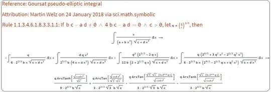

Like any other CAS system, also Rubi follows the rules written by the programmers, so it's always possible to proof by hand how much is executed. Specifically, the theory on which the above rule introduced by Martin Welz is based can be studied in E. GOURSAT Note sur quelques intégrales pseudo-elliptiques (1887). Therefore, based on what is written on page 114, the resolving technique of the integral under consideration can be studied in S. GÜNTHER Sur l’évaluation de certaines intégrales pseudo-elliptiques (1882).
In this case: $$ S \equiv \int \frac{t}{t^3 + 1}\,\frac{\text{d}t}{\sqrt{4\,t^3 + 1}} $$ then imposing: $$ \frac{t}{t^3 + 1} = \frac{\alpha\,t^2}{t^3 + 1} + \frac{\alpha_1\,t^2 + \beta_1\,t + \gamma_1}{t + 1} + \frac{\alpha_2\,t^2 + \beta_2\,t + \gamma_2}{t^2 - t + 1} $$ the identification gives the values: $$ \alpha = \frac{1}{2}\,, \quad \alpha_1 = 0\,, \quad \beta_1 = \frac{1}{3}\,, \quad \gamma_1 = -\frac{1}{6}\,, \quad \alpha_2 = -\frac{1}{3}\,, \quad \beta_2 = \frac{1}{3}\,, \quad \gamma_2 = \frac{1}{6} $$ ie: $$ \frac{t}{t^3 + 1} = \frac{t^2}{2\left(t^3 + 1\right)} + \frac{2\,t - 1}{6\left(t + 1\right)} - \frac{2\,t^2 - 2\,t - 1}{6\left(t^2 - t + 1\right)} $$ from which: $$ S = \int \frac{t^2}{2\left(t^3 + 1\right)}\,\frac{\text{d}t}{\sqrt{4\,t^3 + 1}} + \int \frac{2\,t - 1}{6\left(t + 1\right)}\,\frac{\text{d}t}{\sqrt{4\,t^3 + 1}} + \int \frac{2\,t^2 - 2\,t - 1}{-6\left(t^2 - t + 1\right)}\,\frac{\text{d}t}{\sqrt{4\,t^3 + 1}} \,. $$ Now, for the first integral: $$ S_1 \equiv \int \frac{t^2}{2\left(t^3 + 1\right)}\,\frac{\text{d}t}{\sqrt{4\,t^3 + 1}} $$ according to the method described in the paper: $$ u = \frac{\alpha\,t^3 + \beta\,t^2 + \gamma\,t + \delta}{\sqrt{4\,t^3 + 1}} $$ then imposing: $$ \frac{\text{d}u}{m\,u^2 + n} = \frac{t^2}{2\left(t^3 + 1\right)}\,\frac{\text{d}t}{\sqrt{4\,t^3 + 1}} $$ ie: $$ \frac{\text{d}u}{\text{d}t}\,\frac{2\left(t + 1/t^2\right)\sqrt{4\,t^3 + 1}}{m\,u^2 + n} = 1 $$ the identification gives the values: $$ \alpha = 0\,, \quad \beta = 0\,, \quad \gamma = 0\,, \quad \delta = - \frac{1}{3}\,, \quad m = 27\,, \quad n = 1 $$ ie: $$ S_1 = \int \frac{\text{d}u}{27\,u^2 + 1} = \frac{\arctan\left(3\sqrt{3}\,u\right)}{3\sqrt{3}} + c_1 = -\frac{\arctan\left(\frac{\sqrt{3}}{\sqrt{4\,t^3 + 1}}\right)}{3\sqrt{3}} + c_1\,. $$ Similarly, for the second integral: $$ S_2 \equiv \int \frac{2\,t - 1}{6\left(t + 1\right)}\,\frac{\text{d}t}{\sqrt{4\,t^3 + 1}} $$ putting: $$ u = \frac{\alpha\,t^2 + \beta\,t + \gamma}{\sqrt{4\,t^3 + 1}} $$ then imposing: $$ \frac{\text{d}u}{m\,u^2 + n} = \frac{2\,t - 1}{6\left(t + 1\right)}\,\frac{\text{d}t}{\sqrt{4\,t^3 + 1}} $$ ie: $$ \frac{\text{d}u}{\text{d}t}\,\frac{\frac{6\left(t + 1\right)}{2\,t - 1}\sqrt{4\,t^3 + 1}}{m\,u^2 + n} = 1 $$ the identification gives the values: $$ \alpha = 0\,, \quad \beta = -\frac{2}{3}\,, \quad \gamma = -\frac{1}{3}\,, \quad m = 27\,, \quad n = 1 $$ ie: $$ S_2 = \int \frac{\text{d}u}{27\,u^2 + 1} = \frac{\arctan\left(3\sqrt{3}\,u\right)}{3\sqrt{3}} + c_2 = -\frac{\arctan\left(\frac{\sqrt{3}\left(2\,t + 1\right)}{\sqrt{4\,t^3 + 1}}\right)}{3\sqrt{3}} + c_2\,. $$ For the third integral $$ S_3 \equiv \int \frac{2\,t^2 - 2\,t - 1}{-6\left(t^2 - t + 1\right)}\,\frac{\text{d}t}{\sqrt{4\,t^3 + 1}} $$ this transformation fails and therefore the only hope that remains about the pseudo-ellipticity of the integral consists in further decomposing the rational fraction; in particular, imposing: $$ \frac{2\,t^2 - 2\,t - 1}{-6\left(t^2 - t + 1\right)} = \frac{\alpha}{-6\,t} + \frac{\alpha_1\,t^3 + \beta_1\,t^2 + \gamma_1\,t + \delta_1}{-6\,t\left(t^2 - t + 1\right)} $$ the identification gives the values: $$ \alpha = 1\,, \quad \alpha_1 = 2\,, \quad \beta_1 = -3\,, \quad \gamma_1 = 0\,, \quad \delta_1 = -1 $$ ie: $$ \frac{2\,t^2 - 2\,t - 1}{-6\left(t^2 - t + 1\right)} = \frac{1}{-6\,t} + \frac{2\,t^3 - 3\,t^2 - 1}{-6\,t\left(t^2 - t + 1\right)} $$ from which: $$ S_3 = \int \frac{1}{-6\,t}\,\frac{\text{d}t}{\sqrt{4\,t^3 + 1}} + \int \frac{2\,t^3 - 3\,t^2 - 1}{-6\,t\left(t^2 - t + 1\right)}\,\frac{\text{d}t}{\sqrt{4\,t^3 + 1}} \,. $$ Now, again, for the first integral: $$ S_{3,1} \equiv \int \frac{1}{-6\,t}\,\frac{\text{d}t}{\sqrt{4\,t^3 + 1}} $$ putting: $$ u = \frac{\alpha\,t^3 + \beta\,t^2 + \gamma\,t + \delta}{\sqrt{4\,t^3 + 1}} $$ then imposing: $$ \frac{\text{d}u}{m\,u^2 + n} = \frac{1}{-6\,t}\,\frac{\text{d}t}{\sqrt{4\,t^3 + 1}} $$ ie: $$ \frac{\text{d}u}{\text{d}t}\,\frac{-6\,t\,\sqrt{4\,t^3 + 1}}{m\,u^2 + n} = 1 $$ the identification gives the values: $$ \alpha = 0\,, \quad \beta = 0\,, \quad \gamma = 0\,, \quad \delta = \frac{1}{9}\,, \quad m = -81\,, \quad n = 1 $$ ie: $$ S_{3,1} = \int \frac{\text{d}u}{-81\,u^2 + 1} = \frac{1}{9}\,\text{arctanh}(9\,u) + c_{3,1} = \frac{1}{9}\,\text{arctanh}\left(\frac{1}{\sqrt{4\,t^3 + 1}}\right) + c_{3,1}\,. $$ Finally, for the second integral $$ S_{3,2} \equiv \int \frac{2\,t^3 - 3\,t^2 - 1}{-6\,t\left(t^2 - t + 1\right)}\,\frac{\text{d}t}{\sqrt{4\,t^3 + 1}} $$ putting: $$ u = \frac{\alpha\,t^2 + \beta\,t + \gamma}{\sqrt{4\,t^3 + 1}} $$ then imposing: $$ \frac{\text{d}u}{m\,u^2 + n} = \frac{2\,t^3 - 3\,t^2 - 1}{-6\,t\left(t^2 - t + 1\right)}\,\frac{\text{d}t}{\sqrt{4\,t^3 + 1}} $$ ie: $$ \frac{\text{d}u}{\text{d}t}\,\frac{\frac{-6\,t\left(t^2-t+1\right)}{2\,t^3-3\,t^2-1}\,\sqrt{4\,t^3 + 1}}{m\,u^2 + n} = 1 $$ the identification gives the values: $$ \alpha = 0\,, \quad \beta = \frac{2}{3}\,, \quad \gamma = -\frac{1}{3}\,, \quad m = -9\,, \quad n = 1 $$ ie: $$ S_{3,2} = \int \frac{\text{d}u}{-9\,u^2 + 1} = \frac{1}{3}\,\text{arctanh}(3\,u) + c_{3,2} = \frac{1}{3}\,\text{arctanh}\left(\frac{2\,t - 1}{\sqrt{4\,t^3 + 1}}\right) + c_{3,2}\,. $$ In conclusion, the searched primitive family is $$ S = S_1 + S_2 + S_{3,1} + S_{3,2}\,, $$ which is completely equivalent to that returned by Rubi and therefore evaluating it at the extremes returns what we wanted to prove.

    I misunderstood your reason then, thanks for this! And yes, since it exists and can nicely be performed by Rubi it makes me sure that we can also do it by hand. – Zacky Jul 05 '19 at 15:02
  • @Zacky the CAS does give a proof of the result though: you can easily verify that identity in red via differentiation. – mathworker21 Jul 10 '19 at 16:39
  • @Zacky I think "others" obviously agree it's not interesting for a CAS to spit out helpful information. All I was trying to say though is that you do have a complete, elementary proof that you can do by hand at your disposal now. You claim the identity in red, prove it by differentiating, then apply the limits of integration to it. – mathworker21 Jul 10 '19 at 16:52
