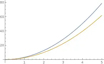

A plot of the two to help visualise it (square area: orange, circle area: blue):
martin
