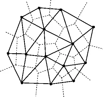

In numerical PDE, especially dealing with conservation laws $\partial_t u - \nabla \cdot\mathbf{F}(u) = g$, there are a class of numerical methods having local conservative properties. For example: Finite Volume Methods (FVM), and FVM's higher order counterpart Discontinuous Galerkin Methods, or Mixed Finite Element Methods.
  • "local conservation of flux" of Finite Volume method: for simple stationary diffusion equation $-\Delta u = f$, the numerical solution $u_h$ satisfies: $$ \int_{\partial K} \frac{\partial u_h}{\partial n} dS = \int_K f \tag{1} $$ where $K$ is a control volume of the original Delaunay triangulation. The control volume is the Voronoi tessellation dual to Delaunay triangulation (dotted line polygon in the following figure): Voronoi
  • If we add time in the equation: $\partial_t u - \Delta u = f$, the local conservation of flux (1) will still be satisfied at every time step if you finite volume method. Due to its simple implementation of this nice property, FVM is very popular in computational fluid dynamics dealing with incompressible flow. A reference of FVM would be this note.
