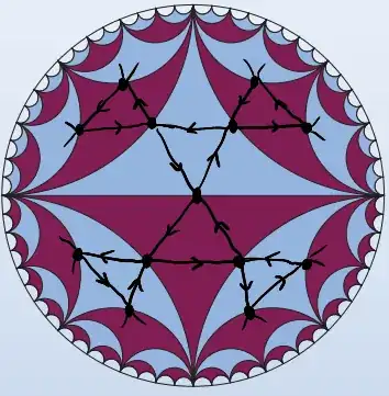

One thing you can take from this is that the space $\widetilde{\mathrm{SL}_2(\mathbb{R})}$ is a natural space in which to embed a Cayley graph for $\widetilde{\mathrm{SL}_2(\mathbb{Z})}$. The group $\widetilde{\mathrm{SL}_2(\mathbb{Z})}$, being a subgroup, acts on $\widetilde{\mathrm{SL}_2(\mathbb{R})}$ by multiplication, so it also acts on the embedding of the Cayley graph. (Hatcher's Algebraic Topology, Example 1.35 gives an explanation of the Cayley graph itself.) The $\mathbb{Z}$ "axis" of $\widetilde{\mathrm{SL}_2(\mathbb{R})}$ spans a geodesic line $L$, and the image of $L$ in $\mathrm{PSL}_2(\mathbb{R})$ is $\mathrm{PSO}_2(\mathbb{R})$. Thus, collapsing the universal cover in the $L$ direction (that is, taking the space $\{gL:g\in \widetilde{\mathrm{SL}_2(\mathbb{R})}\}$) gives the space $\mathrm{PSL}_2(\mathbb{R})/\mathrm{PSO}_2(\mathbb{R})$, which is $\mathbb{H}^2$. Since $$\mathrm{SL}_2(\mathbb{Z})\cap \mathrm{SO}_2({\mathbb{R}}) = \left\{ \begin{bmatrix}\pm 1 & 0\\0&\pm 1\end{bmatrix}, \begin{bmatrix}0 & \pm 1\\\mp 1 & 0\end{bmatrix} \right\},$$ the image of $\mathrm{PSL}_2(\mathbb{Z})$ in $\mathbb{H}^2$ is almost a Cayley graph, except for the fact that order-$2$ loops collapse, as seen in the following graph:
collapsed Cayley graph
Even so, the symmetry group of the resulting graph in $\mathbb{H}^2$ is $\mathrm{PSL}_2(\mathbb{Z})$. It's possible to make a graph with this property with fewer edges by placing a single vertex in the center of each triangle then connecting them by an unorienteded edge across each edge of the triangle---that is, take graph that is dual to the triangulation.
