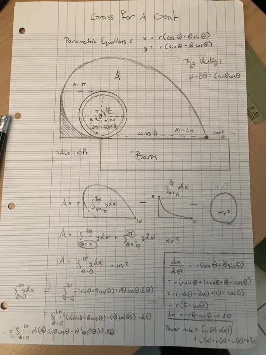

This is an image of the barn (square), the silo (circle) and the goat's grazing area.
The drawing.

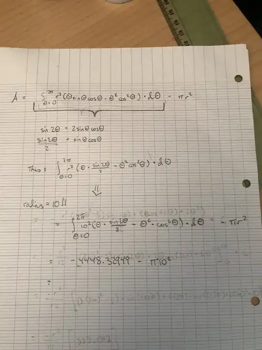

The answer I got is -4762.48876, but area is positive, so i made it 4762.48876.
These are the steps i took to getting the answer I have: The drawing. The drawing.

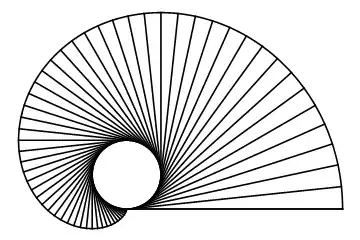

I have found another, much simpler derivation of the result. Let us divide the area of grazing into infinitesimaly thin triangles, as below:
![enter image description here
They all approximately isoceles. The triangle with the apex at point $(R\sin\phi,R-R\cos\phi)$ has the legs of the length $L(\phi) = (2\pi-\phi)R$ (the length of unwinded chain). they are supposed to be very thin, with the angle at the apex being $\Delta\phi$. Therefore, the area of each triangle is
$$\Delta S \approx \frac12 L(\phi)^2 \sin( \Delta\phi) \approx \frac12 (2\pi-\phi)^2R^2 \Delta\phi$$
The full area is therefore equal to
$$ S = \int_0^{2\pi} \frac12 (2\pi-\phi)^2 R^2d\phi = -\frac{(2\pi-\phi)^3R^2}{6}\Big|_{\phi=0}^{2\pi} = \frac43\pi^3R^2$$
