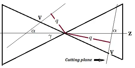

A cone semi-vertex angle $\gamma$ is cut by a plane inclined at angle $\alpha$ to symmetry axis. Length of perpendicular on plane from the cone vertex is $q$.
Conic section sketch
It is known that eccentricity
$$ \epsilon =\frac{\cos\alpha}{\cos\gamma} $$
can be calculated. But can the semi latus-rectum $p$ or its length $\dfrac {q}{p}=f(\alpha,\gamma)$ be represented/found by geometric construction?
Thanks in advance for suggestion of a simple Ruler/Compass construction.

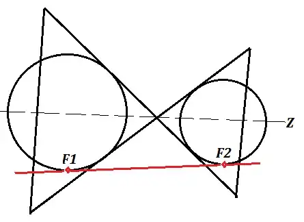

Finding foci for hyperbola intersection drawing direct tangents of Dandelin spheres.. is this how it is done?

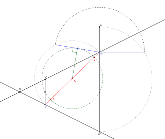

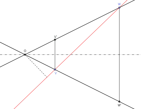

If $V$ and $W$ are the vertices of the conic section, and $VV'$, $WW'$ are perpendicular to the axis of the cone, then the latus rectum is given by (see here for details): $$ 2p={VV'\cdot WW'\over VW}. $$ This is valid for an ellipse or hyperbola: the equation for a parabola can be recovered by letting $OW\to\infty$, where $O$ is the cone vertex.
EDIT.
See below for a ruler-and-compass construction of foci $F$ and $G$, based on the formula for the distance between a focus and the center of the ellipse $c={1\over2}\sqrt{VW^2−VV'\cdot WW'}$.
  • Can the focus be now marked from above definition with a point here or in any other projection/view? Is the intersection of axis of symmetry and (red) cutting plane projection the focus $F$ ? – Narasimham May 27 '19 at 07:56
  • By the same formulas given in the linked answer we can find the distance between a focus and the center of the ellipse: $$c={1\over2}\sqrt{VW^2-VV'\cdot WW'}.$$ The focus is not, in general, the intersection between the plane and the axis of the cone. – Intelligenti pauca May 27 '19 at 11:27

    The foci can be located by Dandelin spheres. In your figure you can construct a circle with center on the cone’s axis, tangent to the sides of the cone and to the cutting plane. The point of tangency on the cutting plane is a focus. – David K May 28 '19 at 19:38

  • For hyperbolic section is it the way Dandelin spheres are contacted with direct tangents? (spheres in different cone sheets ?). – Narasimham May 30 '19 at 07:27

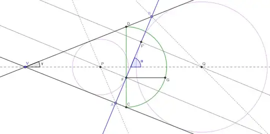

Here is a geometric construction of the foci and latus rectum of an ellipse based on the Dandelin spheres:
Given a cone with vertex at $V$ and semi-vertex angle $\gamma$ cut by a plane at angle $\alpha$ to the axis of symmetry, in a plane through the axis of symmetry perpendicular to the cutting plane the cutting plane intersects the cone at points $A$ and $B$ so that $AB$ is the major axis of the ellipse. Bisect angle $\angle VAB$ and let $P$ be the intersection of the angle bisector with the axis of symmetry. Drop a perpendicular from $P$ to $AB$ intersecting $AB$ at $F.$ Then $F$ is a focus of the ellipse and $PF$ is a radius of the corresponding Dandelin sphere.
The other focus is similarly constructed by bisecting the angle $\angle B$ as shown in the figure (the other bisector would give us $P$ again), finding the intersection $Q$ of the bisector and the axis of symmetry, and dropping a perpendicular from $Q$ to $F'$ on $AB$; then $F'$ is the other focus and $QF'$ is a radius of its Dandelin sphere.
A plane through $F$ perpendicular to the axis of symmetry intersects the cone in a circle perpendicular to the plane of the figure, with diameter $CD$ in the plane of the figure. The semicircle $CD$ in the plane of the figure is congruent to one half of that circle. Construct a line through $F$ perpendicular to the diameter $CD$ intersecting the semicircle at $G.$ Then $FG$ is the semi-latus rectum.
