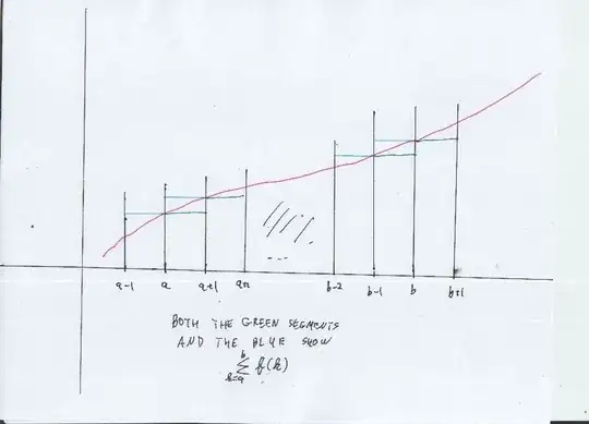

don't need Stirling. For a function such as logarithm with $f(x) > 0$ and $f'(x) > 0,$ we get $$ \int_{a-1}^b \; f(x) dx < \sum_{k=a}^b \; f(k) < \int_{a}^{b+1} \; f(x) dx $$
Here $f$ is log base e, take $a=2$ and $b=n$ $$ \int_{1}^n \; \log x \; dx < \sum_{k=2}^n \; \log k < \int_{2}^{n+1} \; \log x \; dx $$
An antiderivative of $\log x$ is $x \log x - x.$
$$ n \log n - n + 1 < \log n! < (n+1) \log (n+1) - n - 1 - 2 \log 2 + 2 $$
