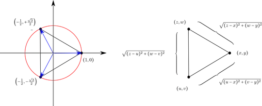

The answer to your question is $$ z_1=1\\ z_2=-\frac{1}{2}+\frac{\sqrt{3}}{2}\cdot i\\ z_3=-\frac{1}{2}-\frac{\sqrt{3}}{2}\cdot i $$ enter image description here
If $\vec{z}_1=(x,y)$, $\vec{z}_2=(z,w)$ and $\vec{z}_3=(u,v)$ then by figure \begin{align} (z-u)^2+(w-v)^2=&(z-x)^2+(w-y)^2\\ (z-x)^2+(w-y)^2=&(u-x)^2+(v-y)^2\\ (z-u)^2+(w-v)^2=&(u-x)^2+(v-y)^2\\ \end{align} By $\|z_i\|=1$, $i=1,2,3$, we have \begin{align} z^2+w^2=&1\\ u^2+v^2=&1\\ x^2+y^2=&1\\ \end{align}
By $z_1+z_2+z_3=0$ we have \begin{align} u+x+z=&0\\ v+y+w=&0\\ \end{align} Now use those $ 8 $ equations to get the answer that was given.
