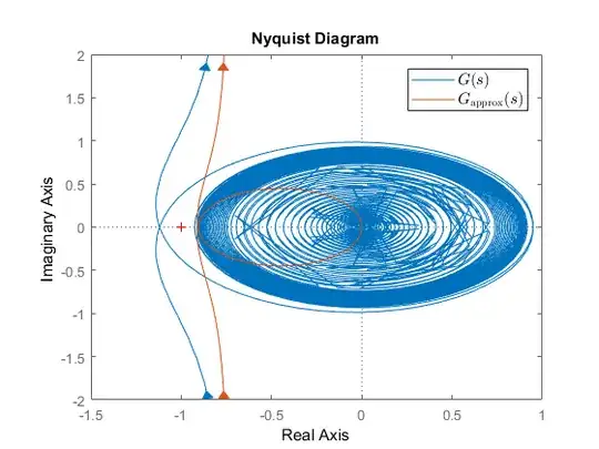

Usually both the delay and the right half plane zero constrain how high you can place the closed loop bandwidth. However a delay really put a hard upper bound on the bandwidth because the phase drop increases linearly in frequency (it looks exponentially when the frequency is on a logarithmic scale). For the right half plane zero it is still possible to get an arbitrary high bandwidth, because the phase only drops at most 90 degrees, however high bandwidths do yield worse and worse margins, for example see my answer here. From this it is also possible to construct an example where the system with the Padé approximation is stable in closed-loop but with a time delay it is not, namely
$$ G(s) = \frac{100\,s + 90}{s^2 + 110\,s}e^{-2\,s}, \tag{1} $$
so
$$ G_\mathrm{approx}(s) = \frac{100\,s + 90}{s^2 + 110\,s}\frac{1 - s}{1 + s}. \tag{2} $$
The corresponding Nyquist diagram can be seen below, from which one can conclude that $(2)$ would be closed-loop stable, but $(1)$ would not.
However I would like to state this should only be the case when you choose a bandwidth high compared to $1/\tau$. Because in my example $1/\tau=0.5$ while the bandwidth lies close to 2 rad/s. I define the bandwidth as the frequency where the open-loop crosses the 0 dB line for the first time, this definition is sometimes also called the crossover frequency. Normally one would already design a controller which would not have a high bandwidth compared to $1/\tau$ if one wants to have reasonable phase and gain margins, even when using the Padé approximation for the delay in this design process. For example adding a gain of 0.848 would give $G_\mathrm{approx}(s)$ a phase margin of 45 degrees (however the gain margin is still only 2.27 dB). With this gain $G(s)$ is stable as well, however its margins a still quite a bit different, namely a phase margin of 15 degrees and a gain margin of 0.455 dB. It can be noted that the bandwidth is still 1.1 rad/s, but even if you do not have a relatively high bandwidth I would still recommend checking whether or not requirements for the margins are met while using the delay instead of the Padé approximation.
Another way of looking at this is considering the phase margin of the system without delay and look at the phase shift induced by the actual delay and the Padé approximation. The phase margin of the system is denoted with $\phi$ at a crossover frequency $\omega_c$. The phase shift at $\omega_c$ of the actual delay can be shown to be $\tau\,\omega_c$, so the maximum delay the system can actually handle can be calculated with
$$ \tau_\mathrm{max} = \frac{\phi}{\omega_c}. \tag{3} $$
The phase shift at $\omega_c$ of a $[1,1]$ Padé approximation can be shown to be $2\tan^{-1}\left(\tau\,\omega_c/2\right)$, so the predicted maximum delay approximation the system can handle can be calculated with
$$ \tau_\mathrm{max,approx} = \frac{2\tan\left(\frac{\phi}{2}\right)}{\omega_c}. \tag{4} $$
The Taylor series of $2\tan\left(\frac{\phi}{2}\right)$ is
$$ 2\tan\left(\frac{\phi}{2}\right) = \phi + \frac{\phi^3}{12} + \frac{\phi^5}{120} + \mathcal{O}(\phi^7), \tag{5} $$
so when comparing $(4)$ to $(3)$ it can be seen that the larger $\phi$ the worse the predicted maximum delay according to $[1,1]$ Padé approximation is, since the Taylor series shown that it always over estimates the delay it can handle (only this over estimation gets really small when $\phi$ is small).

  • I haven't come across this definition of bandwidth before. Is there a reference where I can read more about it? What are its properties? I guess that is the input frequency above which the system dissipates some energy and before it, it adds energy (roughly speaking). Why does this happen if the bandwidth is larger than $1/\tau$? – Nicolas Bert Johnson May 17 '19 at 22:30
  • I used this definition for the bandwidth since this way was taught at my university. Here it is called the crossover frequency instead. Defining the bandwidth as the frequency where the closed-loop goes below -3 dB often yields bigger values then the crossover frequency. Namely crossover looks at $|G(j\omega)|=1$ while the bandwidth looks at $$\left|\frac{G(j\omega)}{1+G(j\omega)}\right|=0.71$$ so at the crossover one usually has that $|1+G(j\omega)|<1$ (true when you have small margins) so the condition for the bandwidth is not met yet. – Kwin van der Veen May 17 '19 at 23:56
  • Often both yield similar values, they only start to differ a lot when you have poor margins, for example the 2 and 1.1 rad/s in my answer turn into 142 and 118 rad/s. So you could still use as a rule of thumb that if the (other) bandwidth is below $1/\tau$ the first order Padé approximation can be used to approximate a delay. The bandwidth might be a little bit conservative compared to the crossover though, I mainly mentioned it in my answer as an order of magnitude comparison, not a hard cut-off. – Kwin van der Veen May 18 '19 at 00:16
  • @NicolasBertJohnson I added quite a bit to my answer. In the section where I use the phase margin it can also be seen that the crossover frequency is useful there as well. One can also always check closedloop stability by looking at the phase margin of the openloop (without delay) and use equation $(3)$ to find the maximum delay the system could handle. – Kwin van der Veen May 20 '19 at 03:25

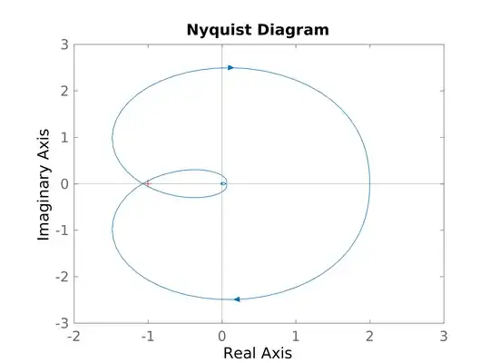

You can find a counterexample by using a BIBO-stable open-loop system with poles close to the imaginary axis and an intermediate value of $\tau$ (not too low, not too high). Here is an example:
$$ G(s) = \frac{2}{(s+0.5)^2 + 1}e^{-0.6s}. $$
The closed-loop function $G_c(s) = G(s)/(1+G(s))$ is approximated by $$ \tilde{G}_{c} = -\frac{80-24s}{12s^3 + 52s^2 + 31s + 130}. $$
Its poles are $-0.0085 \pm j1.5842$ and $-4.3163$ (I determined these using MATLAB), so the approximate closed-loop system is BIBO stable (you can use an algebraic criterion to verify this), but the Nyquist plot of the actual open-loop transfer function is
Nyquist counterexample
Indeed, for $\tau > 0.5758$, the closed-loop system becomes BIBO unstable, but it is not until $\tau>0.6189$ that you will be able to detect this using a $[1,1]$-order Padé approximation.

    I think you might have made a typo, because the Nyquist diagram seems to correspond to $$G(s)=\frac{2}{(s+0.5)^2+1}e^{-0.7,s}$$ and not $$G(s)=\frac{2,s}{(s+0.5)^2+1}e^{-0.7,s}.$$ However for $\bar{G}_c(s)$ you did seemed to have used the $G(s)$ with the extra $s$ in the numerator. – Kwin van der Veen May 18 '19 at 02:08
  • @KwinvanderVeen that's a lot for noticing! I'll fix that. – Pantelis Sopasakis May 18 '19 at 02:15
  • I think your answer is still not completely correct, namely I have added to my answer a way to calculate the maximum delays and for your example system this would give $\tau_\mathrm{max,approx}=0.6188$ (close enough) and $\tau_\mathrm{max}=0.5758$ (this one does differ significantly). – Kwin van der Veen May 20 '19 at 01:42
  • @KwinvanderVeen You might be right. I determined these values by trial and error (maybe there was an error in my code). I'll double-check tomorrow). Thanks a lot. – Pantelis Sopasakis May 20 '19 at 01:44
  • @KwinvanderVeen I updated my answer with a MATLAB script to compute these values. Thanks again. – Pantelis Sopasakis May 20 '19 at 02:29
