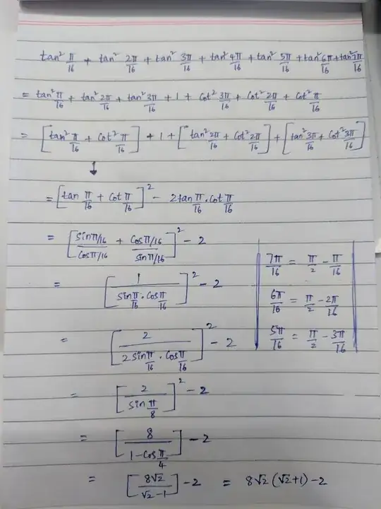

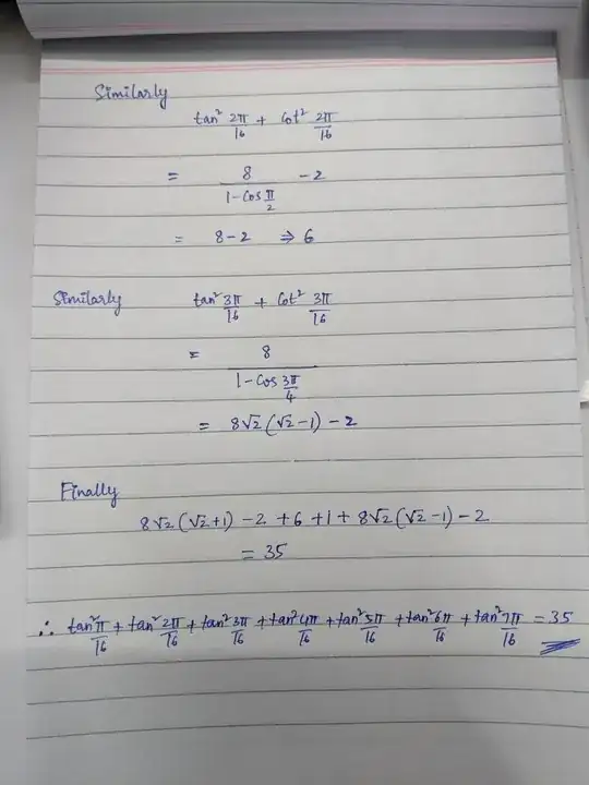

enter image description hereenter image description here
The summation is 35 and subtract -1 because tan pi/4 is 1
Finally the result is 34
