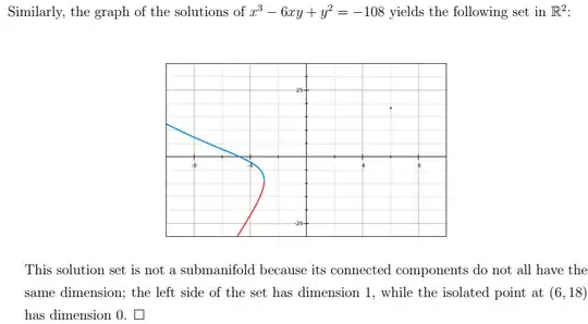

  • But now consider Problem 9.1: The answer given is all real numbers except $0$ and $-108$. A solution given by Richard G. Ligo claims that the reason (or a reason) why $x^3-6xy+y^2=-108$ is not a (regular) submanifold of $\mathbb R^2$ is that connected components do not have the same dimension.

  4. Tu intended a definition that allows submanifolds to not have dimensions. However, $S$ is neither a submanifold nor a $k$-submanifold of $\mathbb R^2$ for a different reason.
  5. Tu intended a definition that allows submanifolds to not have dimensions and should have allowed $S$ to be a submanifold of $\mathbb R^2$ even though $S$ is not a $k$-submanifold of $\mathbb R^2$. Thus each nonzero $c$ gives a submanifold with or without uniform dimension (same dimension for each connected component), while $c=-108$ is the only nonzero value that gives submanifold without uniform dimension.

...The critical values are 0 and -108, but the inverse image of -108 is a regular submanifold. Your interpretation is correct...
To me, a manifold or a submanifold can have connected components of different dimensions, so the set in question is a regular submanifold of $\mathbb{R}^2$ with one connected component of dimension $1$ and one connected component of dimension $0$.
