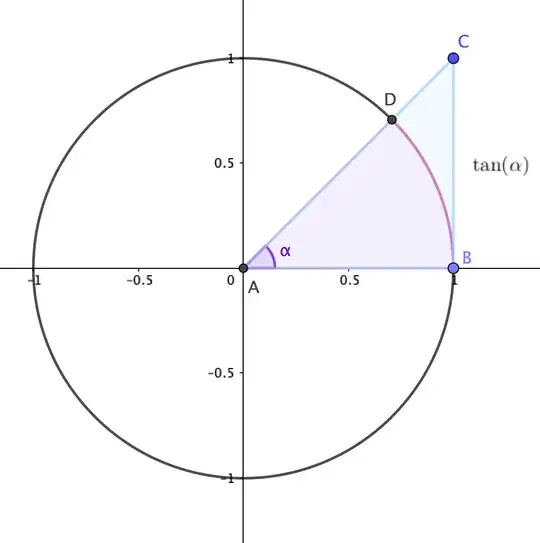

There is also a nice geometric proof
It follows from the areal comparison of $$\triangle ABC=\frac{\tan(\alpha)}{2}>\text{circular sector }ABD=\frac{\alpha}{2\pi}\cdot(\pi\cdot1^2)$$ Or equivalently $$\frac{\tan(\alpha)}2>\frac\alpha2\iff \tan(\alpha)>\alpha$$
