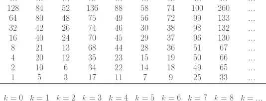

Visualizating non-cyclicity of eventual counterexamples of the Collatz conjecture
This is a matrix of n as a function of k = odd steps. The even numbers descend to an odd number (divided by 2) and the odd numbers jump to the left column (3n +1). It will be useful for visualizing because the cycle 1,4,2,1 is the only possible cycle. Otherwise,
$f\left ( n \right )= n$ , and this is only possible when n = 1, taking the odd n. This implies that the function takes a value from the form
$f_{0}^{k}\left ( n \right )= \frac{n\times 2^{x}}{2^{x}}$
and the even numbers of the form $n\times 2^{x}$ are the numbers where n comes from and therefore the function does not go through those numbers again. In the matrix, they are always above n and the function always moves downwards for even and to the left-up for the odd ones, looking for its corresponding pair number. It is easy to see that the function from n always leaves behind the numbers that would give rise to another cycle other than 4, 2.1. Mathematically, for now, I do not know how to express it, it’s as if the function had to do the reverse cycle for this to happen. P.D.: I do not know about your proof(correct or incorrect?) but I think it could be useful to prove the inexistence of another cycle than 1,2,4,1.
